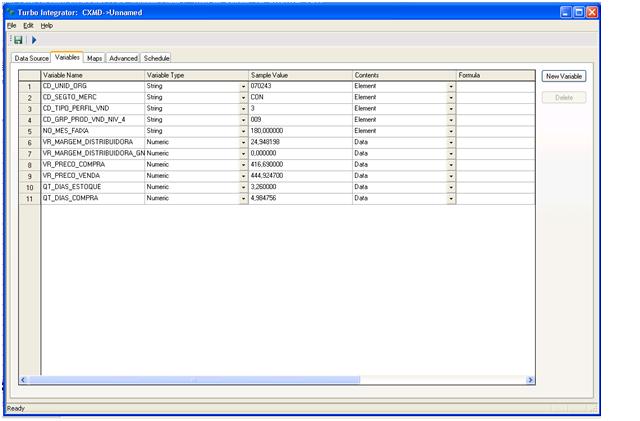

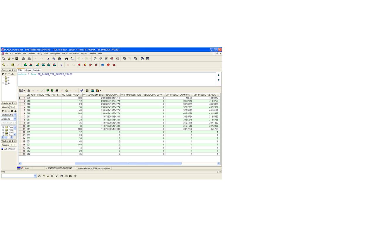

Hello all,
I created a cube through a table from the database. This cube will output to return the information to the database.
When the table has only one field as I can post normally, but when the table has more than two fields of measurement, time to specify the variables that the cube can not recognize that I have two fields of measurement. Has anyone experienced this?
Annex demonstration of the fields in the table, VR_MARGEM_DISTRIBUIDORA_GNV, VR_PRECO_COMPRA, VR_PRECO_VENDA measurement fields of the table.

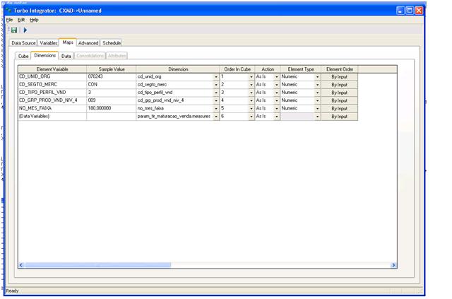

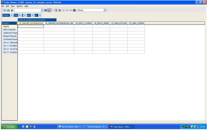

My problem is to generate the cube. I am creating a cube through a table from the database. When my table has only one field measurement, for example, a table with 4 fields and one of this measure, to create the cube, how do I set up three columns and a string as data variables tab, tab TM1 dimensions takes on the dimension measurement implicitly create this cube and then make his publication in the database, with the same table structure. When the table has more than two fields of action, variables tab I set all fields of measures and dimensions in the TM1 guide asks me to create a measures dimension to my cube when I'll publish this cube on the table, the database means that the field names as the size of the cube are string, preventing me from publishing.
Note the image of the cube, the fields are not measures of dimensions rather than one dimension items, my problem is this. I need fields'' are'' measures as dimensions so I can publciar the cube in the database.

Your problem is, to put it as delicately as possible, difficult to fathom.aleferrer wrote:

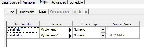

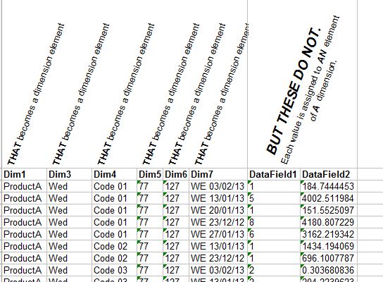

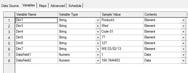

If you have a data source with multiple data columns it will look something like this: If you DO insist on using the wizard the setup will look something like this: Each of the "Element" columns represents one element in one dimension. To put that another way, each column relates to one distinct dimension. Each row represents one element in the corresponding dimension.
But ALL of the "Data" columns relate to ONE single dimension. Each column is simply assigned to different ELEMENTS of that dimension.
Consequently your Maps tab /Dimensions sub-tab will look something like this, where every "Element" column has to specify the dimension that the element appears in. And note that "AsIs" only works if the dimensions /elements already exist. If you need to add any new elements as they come in through the data feed, change your setting accordingly. (Refer to the TI manual for an explanation of what each option does.)
All of your "Data" source columns are grouped into that last row. Note that you have to specify which dimension the values contained in those columns will be written to. This will be what I assume you're referring to as your "measures" dimension. I've called it zDimData, you can call it whatever you want; I can't read the name of the dimension that you have in the columns area of your last screenshot, but that would probably be it. To assign those columns to elements in that dimension you have to move to the Data sub-tab of the Maps tab.
In this case I've used different element names from the column names. In your case you will probably use the original column names from your data source as your element names. These will then become the individual elements of your "measures" dimension that you have running across the top of your screenshot.

Hi aleferrer,
Thanks for all the extra stuff. I will have a read over the weekend but just wanted to point you to a couple of posts that I think are relevant to the problems that you are having.
Your recent comments seem to indicate that the cube is being created fine but that you are having difficulty in publishing to a SQL database when there is more than one measure. This is quite a common problem and has been addressed in a couple of places before.
The fundamental problem is that when you use a TM1 cube as a TI datasource it gives you a record for each populated cell but what you want is a record for each row of populated measures so that you can turn it into a SQL insert statement.
Have a look in the following posts and see if they help.
Duncan.

I have a small example here of the technique. It uses an indicator measure to mark which rows have values in any of the measures and it outputs to file the SQL statements that it would have issued to the ODBC connection.
The key is in the definition of the view "indicator" which you must look at from within the process editor.
