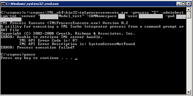

Hello forum. Starting to use TM1processexecute and got an error
have you achieved the same result? i pasted tm1servername directly from cfg file, tried to change adminhost for full name or ip...

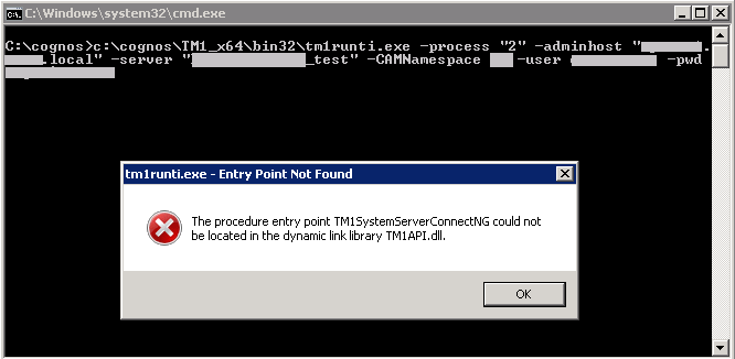

Tried to use TM1RUNTI.EXE... And got the error that even is not googlable - TM1SystemServerConnectNG

You have the parameters in the wrong order. It should be TIProcessExecute AdminServer TM1Server UserID Pwd ProcName (and then parameters if needed). In the example you give you have the process name at the front. Additionally, for tiprocessexecute you don't need the switches (so you don't need -process for example). If you just type tiprocessexecute at the command prompt it will tell you the correct usage.

is there any ability that reason is incompatibility of TM1 x64 and his dlls and processexecute x32 ?..

No (I think). I use tm1processexecute extensively and very successfully with TM1 x64 9.52. I normally copy the tm1processexecute.exe to the TM1 x32 client directory (which will depend on your version).

so have to install 32 bit version on the same server or in is possible to use some other linked machine?

As long as it has the correct access to the TM1 dlls etc (effectively a client directory) it will be able to access whatever servers and TI processes that the user specified in the command has rights to. So, yes, it could be from any correctly set up machine.
