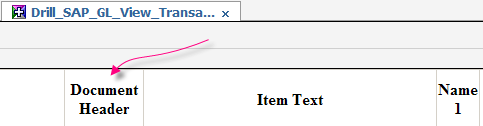

Ow c'mon guys, there must be a way to apply styles to the dataset header (Fields). The default formats are terrible..

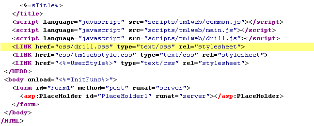

Okay, what i've found so far is in ..\inetpub\wwwroot\tm1web folder, the page RelationalDialog.aspx has a few style sheet references;
drill css01.png (9.8 KiB) Viewed 5646 times
the drill.css seem to change stlyes for the data section (.cell{ } class) and for the rest of the page such as the data header, not sure where it is..
