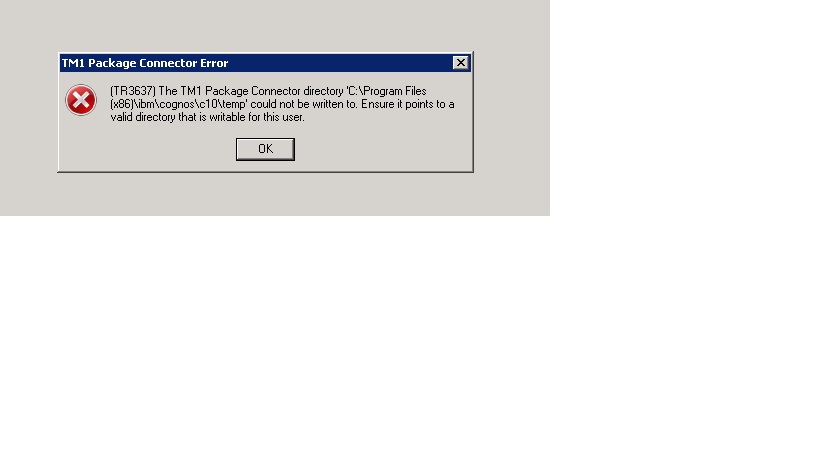

I am getting an error while opening Architect. Please find attached.
Can anyone help me out to resolve this?

Probably worth checking that the named directory exists and can be written to
If you aren't using the Package Connector (and I don't think many people do) you might want to check whether there's a reference to that directory in your tm1p.ini - see
http://www.tm1forum.com/viewtopic.php?f=3&t=7968 for how to find this - and commenting it out.
