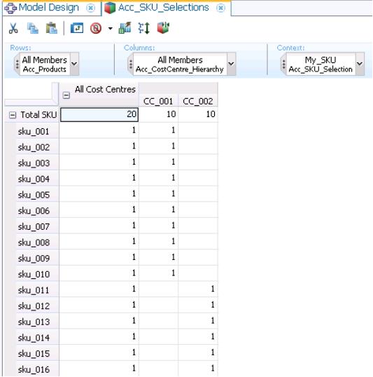

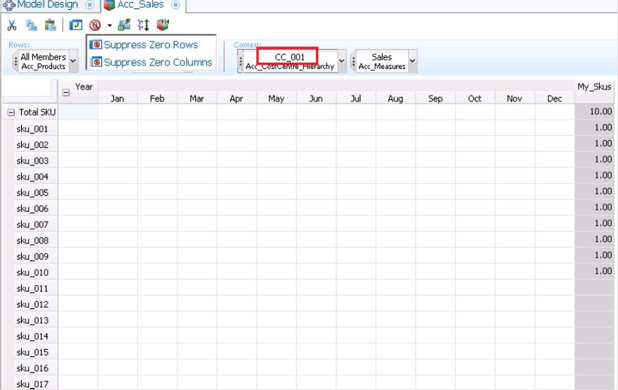

I have done this:
1. create a selection management cube(that could be populated from the Pricing data to activate permitted combination)
2. Passed this flag into a month called 'My SKUs' in the Input cube.
3. Configured the View to use zero suppression.
This gives me full flexibility as any cost centre can be managed independently and cost centres and sell some of the same products.
I have attached the screens showing the work.
What do i want now? A dynamic subset that can filter on multi-diemnsional data values (where combination/tuple=1) or a multi-dimensional attribute.
Manage Selections
Manage Selections
manage selections.JPG (33.16 KiB) Viewed 5448 times
Pass selection to input cube
pass selections to Input cube.JPG (54.52 KiB) Viewed 5448 times
