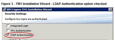

Hi Gurus, :)
Just need help. How will I be able to see the authentication mode that was chosen during the installation. This is Tm1 version 10.1.1.
See attached image.
Thanks very much guys.
Authentication option.jpg (28.66 KiB) Viewed 2579 times

bunchukokoy wrote:How will I be able to see the authentication mode that was chosen during the installation.
This is setting up the parameters in the tm1s.cfg file for whatever TM1 instance you are deploying as part of the install (default being Planning Sample, or similar). You can go and change these parameters later and you can have different parameters for different TM1 instances. Just because you install TM1 and make this selection doesn't mean you are stuck with it later on.
Depending on the selection it will set IntegratedSecurityMode and if you select LDAP you will probably have to enter something to inform these settings.
