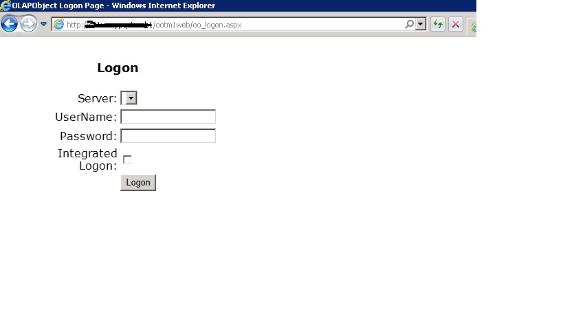

I am facing a problem after installed OLAPObjects for TM1. Unable to find the Server. I have verified my TM1 admin server and it is up and running. I have installed OLAPObjects in the WEB Server. am I missing any configuration part that point admin server for the OLAPObjects?
Please find attached screen shots.

Is OO on a separate server from the TM1 server? I think it's usual to have them on both, nevertheless it should simply be a matter of updating your web.config file to point to the correct admin host to be able to connect to the server.
