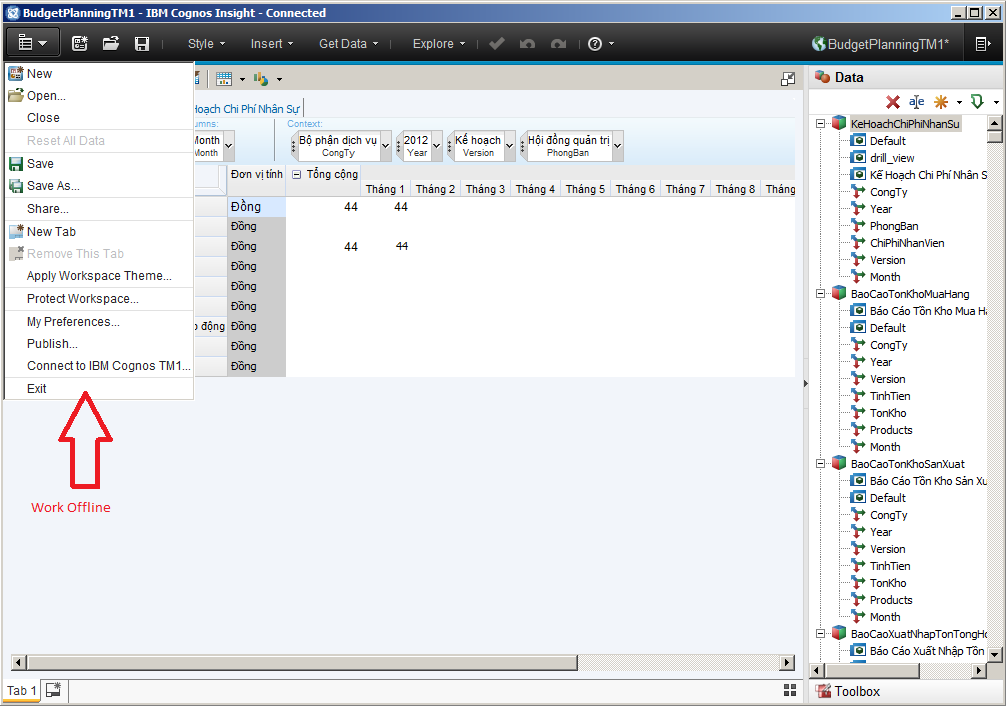

I installed tm1 version 10.1.1, but i don't see features 'work offline' in Cognos insight 10.2
http://pic.dhe.ibm.com/infocenter/cinsi ... fline.html
Cognos insight Work offline with tm1 system
- Insight.png (78.83 KiB) Viewed 5395 times

Looks like you are in "connected" mode. As far as I know work offline is only available in "distributed" mode ...

Can you give me some screenshot about work offline in cognos insight with distributed mode, please!

To skinners666 point,
You will only see work offline if you have an application and it has been setup for distributed mode. You appear to simply be connected to the tm1 server in connected mode in your picture.
From where you are currently you would have to model and application and check the distributed mode box as an option when publishing that application. Then from the application screen you can open the element node in distributed mode which essentially opens a slice of that application locally on your machine using Cognos Insight. After these steps you will see work offline.
