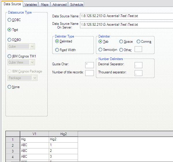

Hi Tomok,
I am able to preview the data when I place the files in one of our windows server. But when I run the process it gave the error 'Unable to open data source'.
Can you please explain in detail how do I give the security access for TM1 Account to the data files and define the UNC path.
Please check the attached scree shots for the further details

Re: To load data from files without placing them on TM1 serv
sreesuku wrote:I am able to preview the data when I place the files in one of our windows server. But when I run the process it gave the error 'Unable to open data source'.
I am not sure what you didn't understand as it should be pretty clear!
When you preview the data source you are opening the file identified by "data source name" with your user credentials.
When the TM1 server accesses the data source at runtime it uses the file identified by "data source name on server" using the user credentials of the account running the TM1 service. If the location is on a network resource then the account used to run TM1 must have access to that location. If TM1 is being run under the server local admin account then it will be able to access only files on the same physical server.
Post by Andy Key »
When you preview the file, you are running the preview in the context of the user that you are currently logged on as, and using the file name as supplied in the Data Source Name box.
When you execute the process, you are doing so in the context of the user account that is running the TM1 service, and using the file name as supplied in the Data Source Name On Server box. Have a look in the Windows Services applet, find your TM1 server service and check the Log On As field. Unless you have changed this, it is probably set to the Local System account. As the name suggests this is Local to the machine and nothing to do with the domain, so won't have any access to the other server where your data file sits.
