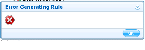

Am experiencing a new problem in Performance Modeler (PM).
Having created calcs in a dimension i found that the rules editor stopped autogenerating new Rules ata certain point.
I have cleared the rules and tried the 'Generate Rule' button. This has not rebuilt the rules.
I have tried creating new cubes with just two dimensions to see if that was 'easier' but now not generating any lines in the editor using this dimension.
Any thoughts? It is important to continue using PM.
Mark
I have attached the 'generate rule' error

I know this won't be particularly helpful, but it's a good example of why Performance Modeller will never be the standard in TM1 development.
Seriously, an error popup with no message?
Sorry, I don't have an answer for you, because I don't use PM.

Have you made any changes in the rule in Architect/Perspectives? I would try shutting the server down, physically removing the .RUX file (and the .BLB if it exists) and restarting the server.
