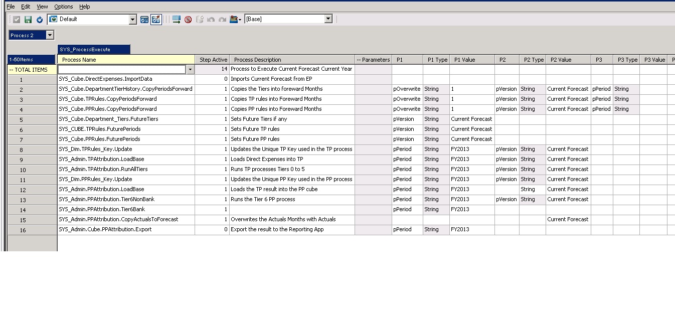

I have recently encountered something similar where i needed to execute chores using TM1RunTI which according to the documentation it cannot do (I believe it will only execute processes).
My work around was to build a cube with a pick list to }Processes and the ability to specify parameters and their values. I then have a central process with a parameter to identify the process you wish to run that gets called from the command line. This way you execute the processes in a sequence you want and still easily update the parameters if they need to change. I also have active flags so you can easily disable individual steps or the complete process if needed.
See the screenshot for a rough idea of how it works.
