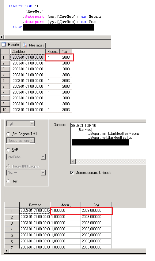

Hello!
As help says, DATEPART returns an integer. But TI process sees it as float. How to solve this newbie trouble? I need to use items as elements of dimensions.

wowow! of course they set to string! another way i can't use them as elements of dimension in process!

in Russia we call this solution "The Crutch" cos it does not solve reason but mask it and cost lot of machine resources and may cause to reworking if some conditions change. I believe best solution exists, but i can't find it myself.

tomok wrote: What help would that be? Not TM1, since that's a SQL function.
you are right, i mean http://msdn.microsoft.com/en-us/library/ms174420.aspx
tomok wrote: That's because as far as TM1 is concerned there are only two data types, floating point numeric and text. The concept of an integer does not exist. If TI detects only numeric characters in a field of a data source, it is going to assume the data is numeric and therefore show it as floating. There is no way around this. You really have only two options; 1) convert the field to text using NumberToString (my recommendation) or 2) trick TI into thinking the data is string by concatenating a letter to the end of field (as part of your SQL statement) and then deleting the character in the TI by using the SUBST function. I don't know why anyone would want to try option 2, I just threw it out there for kicks. As to option 1, I use it all the time, don't see what the big deal is.
