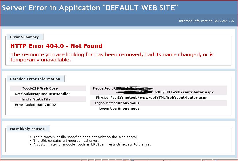

Re: HTTP ERROR 404.4 server not found
please find the below screen shot for the error message, IIS-7 installed.
OS: Windows 2008 server 64-bit.
Excel 2007
with remaining prerequisites installed.
I have installed TM1 set up, I get this error when I select application on IBM Cognos TM1 Application page.
Please help me.
TM1 10.1
Excel 2007
Thank you
Excel 2007
Please help me.
TM1 10.1
Excel 2007
Thank you
Here is an IBM article referring to what I spoke of earlier. http://www-01.ibm.com/support/docview.w ... wg21456607
The other thing you might want to verify is that your web.config is setup to use the version of .net you have the site running under. If you have it running under .net 4 (which might be the case in IIS7), you will need to change the config to support 4. Here is a link on how to do that. http://www-01.ibm.com/support/docview.w ... wg27024528

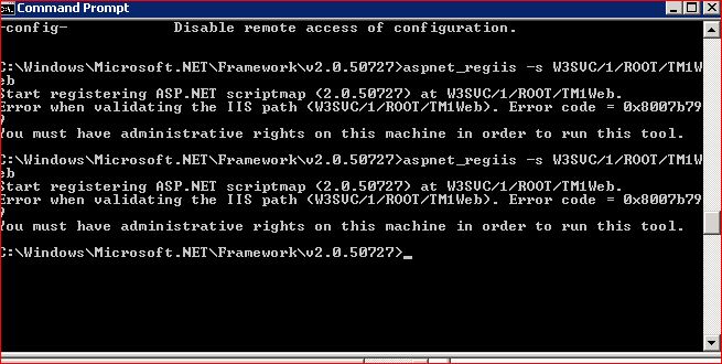

Hi Chet_watkins,
Thank you for your suggestion, I have gone with your suggestion but I am facing an error not having admin rights. I am the admin for this server. Please find the attched.
Please can you suggest me for this.
Try doing it directly through IIS, here is a link on how to set it through IIS6 or IIS7.
http://blogs.iis.net/nitashav/archive/2 ... sions.aspx
If you want to succesfully run this from the command line then your best option is turning off UAC.
Menu Start > Control Panel > System and Security > Action Center > Choose Your UAC Level > Never Notify > Restart machine
