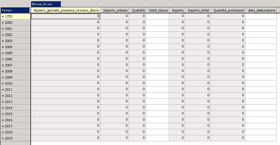

I perform what I wrote, as you can see in the attached picture, but measure value are zeros.
I used the "recalculation" function but values are still zeros.
What's wrong?
Thanks!

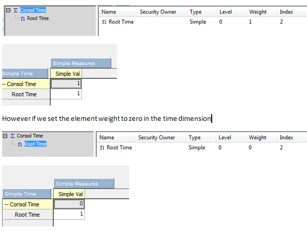

How have you created you time dimension? Your picture shows consolidated time elements, do you see values when you expand the time hierarchy? Did you give elements in the time hierarchy a weighting to make them consolidate?
Hopefully the scenario below might explain.

Time dimension has a hierarchy structure and weigth are equal to 1 (if you want you can see my time dimesion here http://www.tm1forum.com/viewtopic.php?f=3&t=8123)
I'm thinking the cause of the problem is due to the cube action of the process. I must update the cube to load data, isn't it?
I will try and I'll write the result
Thanks!

Right! I must update or create a cube to see the measures values
Thanks for your help
Re: Create Measure Dimension
Rosanero4Ever wrote:I'm thinking the cause of the problem is due to the cube action of the process. I must update the cube to load data, isn't it?
Sure, you must execute your Turbo Integrator process to load the data into the cube.
If not, values in the cube will be 0.

Or you could expand all of the hierchies and type a value in to see if you then get a consolidated value when you refresh/recalc
