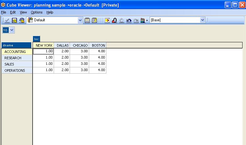

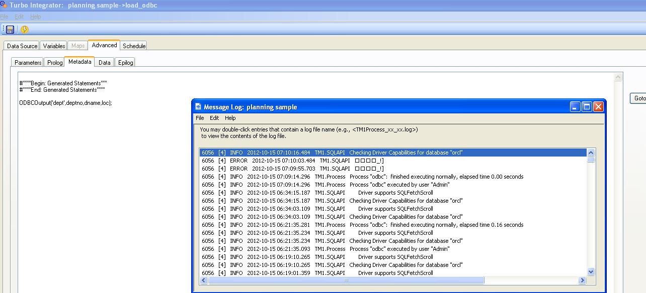

I have tried to load data into dept table in oracle from TM1. The procedure I have tried is,
1) Established ODBC driver.
2) In TI selected odbc source, datasource is orcl, given user name and password and written query is select * from dept. I got data with deptno,dname,loc.
3) Mapped this to dimension with the the same names and created cube with this dimensions as Oracle.
4) Entered data in the cube and saved as default view.
5) Again in TI selected source as TM1 cube view and followed the procedure and written in Metadata tab as shown in the below figure and got error as shown in it.
Please guide me with suggestion and ideas for my requirement.

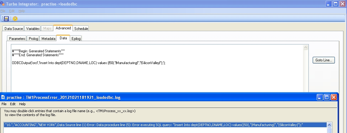

Re: ODBC drive error for Oracle database
Hi Tomok,
Thank you, but still I am facing an error.
My exact requirement is, I want load a row/column in the dept table of oracle database. Thats what I am trying please correct me if anything is wrong.
I tried with your suggestion but I am facing an error, please find the attachment for the comment of the error.
- apostrophes.JPG (199.99 KiB) Viewed 12066 times
charan
- Posts: 148
- OLAP Product: cognos tm1
- Version: 9.5
Hi Tomok,
Even if use four quotes like ''''|Manufacturing|'''' still I face the same error.

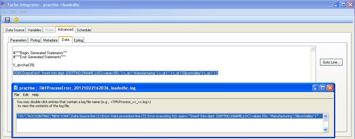

Please use the function ASCIIOUTPUT or TEXTOUTPUT to investigate your exact sQL query.
Obviously you are having problems with ' and " characters.
What Wim meant is that you can write the generated query text to a text file so that you can see what the generated query statement looks like. But, as shown in the screenshot above, you can also see this in the generated error message - and as you can read from there the generated code is far from correct SQL...charan wrote:Hi Wim,
I did not get you exactly, what you are suggesting me, I tried with Textoutput function and getting all the odbc cube data in CSV file exactly, but I did not get how to put in ODBCOutput function. Help me in this.
Thank you
When you have trouble with the quote character you could use a variable for this and use this variable on the places where you would like to see the single quote in the generated SQL statement. This way your statement should look something like this:
v_qt = Char(39);
ODBCOutput('orcl', 'Insert Into dept (DEPTNO, DNAME, LOC) values (50, ' | v_qt | 'Manufacturing' | v_qt | ', ' | v_qt | 'SiliconValley' | v_qt | ')');Michel
Hi Michel,
Thank you, but still error is the same.

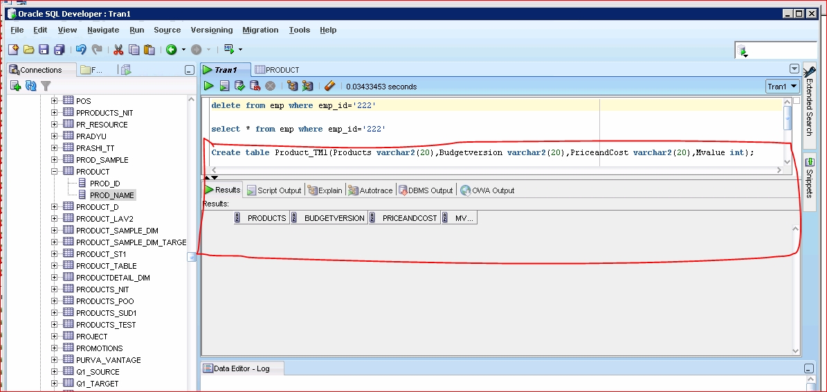

Hi Tomok,
please find the attachment what I am trying to do. Image is the table I created for loading cube view data. I want all cube view data into the table.
please suggest my syntax where I am getting error after Values statement.
Thanking you
Thanking you
- image001.JPG (303.26 KiB) Viewed 11993 times
