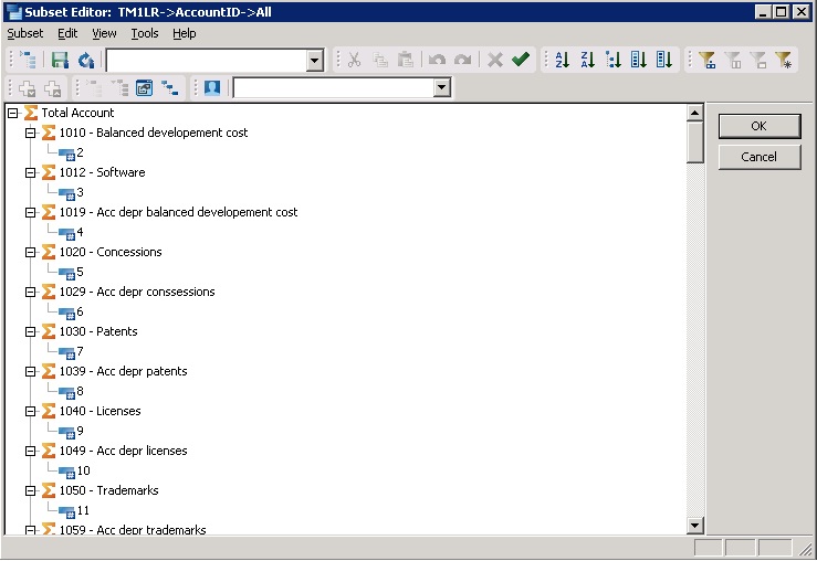

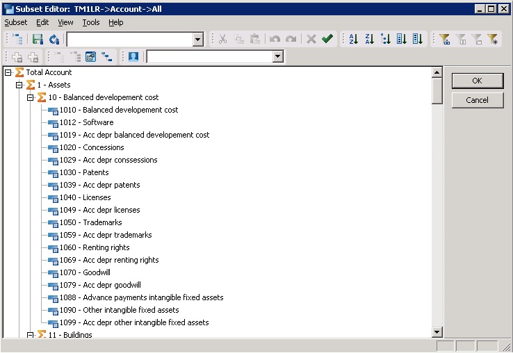

Below are the Account and AccountID dimensions. It is probably as you say that i have to create a attribute but the problem is that i could have multiple ID for one account. This will not work as an alias right?
Br
Peter
Br
Peter

Duncan P
- Posts: 600
- Version: 9.5.2 10.1 10.2
- Excel Version: 2003 2007
- Location: York, UK
Re: No consolidated data when applying rules
You are right that it would not work as an alias (I presume you mean on the target dimension). You will just have to use ATTRS in your feeder statement as I have shown, unless you can guarantee that the parent of each source leaf will always be in the target dimension, in which case you can use ELPAR.

- Structure
- Structure.jpg (30.28 KiB) Viewed 10480 times
You've only shown us the details behind one of the dimensions (Account) and based on your feeder statement, your assertion is that every single dimension is structured the same way, i.e, there is a parent level consolidation in the source dimension that corresponds with a leaf level element in the target. This seems a bit dubious to me. I can see that for the Account, Project, Brand, Business Partner, etc., but the Calendar Period and Fiscal Period??? Your feeder is not going to work unless that is the case EXACTLY. Perhaps you should post screen shots for ALL the dimensions.
All dimensions are structured in this way. Specially the time dimensions (fiscal and calendar) since those are per day but the client only want it per month. This will give me alot of ID below the month.
So... I should work, shouldnt it?
