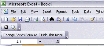

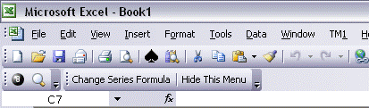

This has been an annoyance for ages but i've never found a solution as yet. When you create a floating menu bar you can control where it's placed on the screen, but if you use top/left/bottom/right it "stacks" the new bar next to the others even if there is loads of space on the bar. If you have addins that only take up a small amount of screen space, it drives me mad because it takes far too much screen space unnecessarily.
Anyone know how to control the location within the bar, so that it automatically looks like the 2nd screen rather than the 1st when it's loaded?

At first I was in a state of puzzlement about that post. Then it dawned on me that you were talking about adding the toolbar via VBA, not the GUI.
I believe that the following code provides what you need. It will add a new toolbar to the right of the Standard one, if the Standard one is there. If there's already a further toolbar to the right of that, that other toolbar will just be shoved further to the right.
The key to it is assigning the .Left property and the .RowIndex property to the new toolbar, the latter of which MUST be assigned directly from the property of the toolbar that you're putting it to the right of, NOT via a variable.

Oops, yeah i probably could have made the fact that i was creating the bars with VBA a little more obvious
Thanks for that Alan, makes perfect sense now. The biggest issue was the row property, understanding that has removed my annoyance and now i have a toolbar that does what it should rather than take up half the screen, cheers
