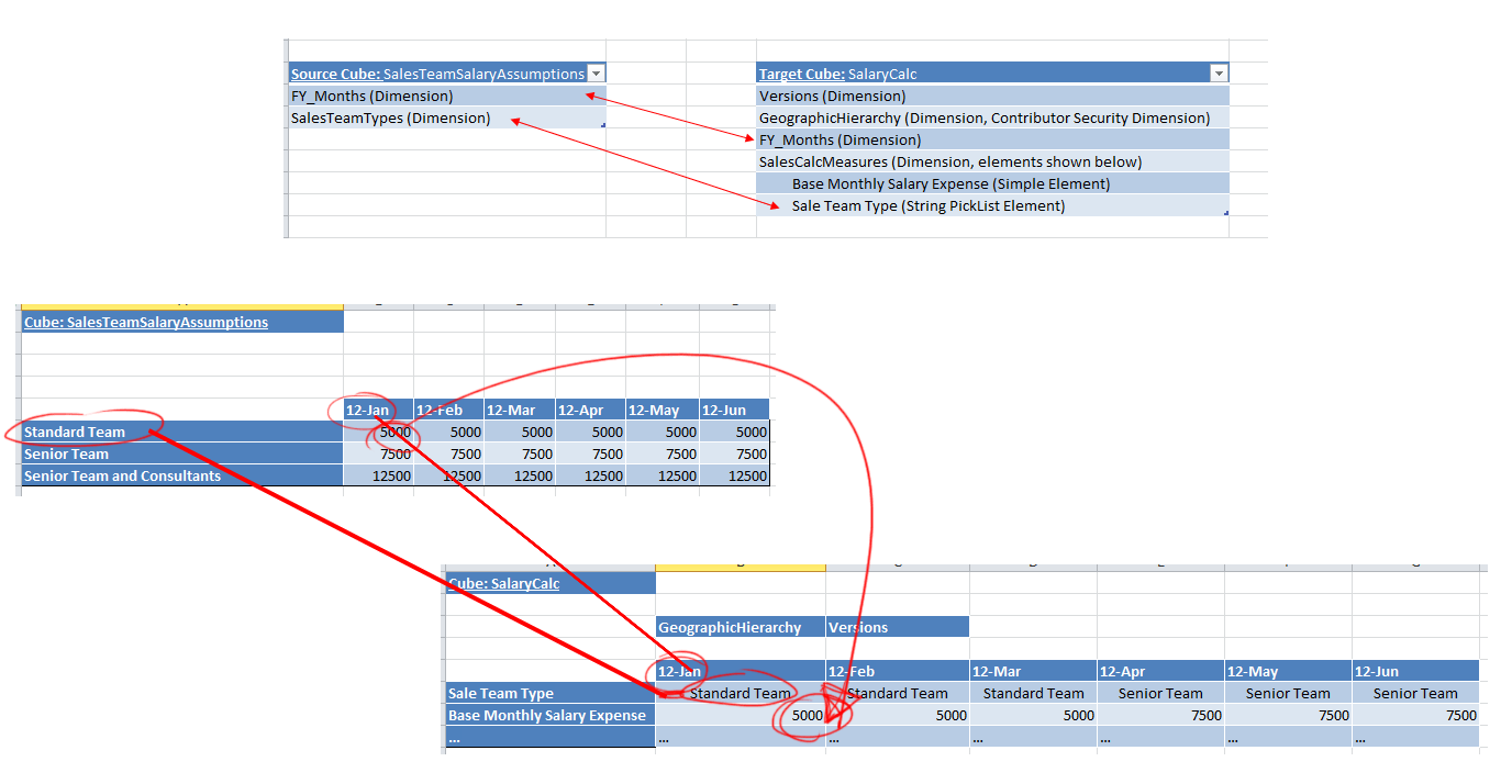

Hi all
I'm trying to write the equivalent of a simple Virtual "Lookup" D-Link, where a real dimension in the Source cube is matched against a Virtual dimension in the Target cube.
In this case, the Target Cube has one Element of the Measures dimension which is a PickList -- the PickList is sourced from a real dimension.
I've included a pic which shows the behavior I'm looking for. Note that the source cube does not have the GeographicHierarchy, which is the Security dimension for the Contributor Deployment (not sure if that's going to cause a problem once Deployed).
At any rate, I'm having issues getting the data from one cube to the other. I've tried several ways of referencing the PickList in the target cube, but none seem to jive:
Variant 1:
['Base Monthly Salary Expense' ] = N:
DB('SalesTeamSalaryAssumptions',
ATTRS('SalaryCalcMeasures', 'Sale Team Type', 'PickList'),
!FY_Months);
Variant 2:
DB('SalesTeamSalaryAssumptions', DB('SalaryCalc', !Versions,
!GeographicHierarchy, !FY_Months, 'Sale Team Type'),
!FY_Months);
Variant 3:
!GeographicHierarchy, !FY_Months, 'Sale Team Type',
!FY_Months),
'PickList'),
!FY_Months);
So, my questions are:
1) What is the proper expression to reference the information I'm looking for?
2) What's the corresponding FEEDER statement, and what kind of overFEEDING issues should I watch for?
Thanks!

- Lookup D-Link in TM1
- Lookup D-Link in TM1.gif (45.38 KiB) Viewed 9362 times
Re: Virtual Dimension Lookup D-Link equivalent in TM1 9.5x
I no nothing of this "Virtual" versus "Real dimension. In TM1 there is a dimension, period. This must be a Cognos Planning thing. Here is your rule:
The feeder would be:
['Base Monthly Salary Expense' ] = N:DB('SalesTeamSalaryAssumptions',!FY_Months,DB('SalaryCalc',!Version,!GeographyHierarchy,!FY_Months,'Sale Team Type');
['Sale Team Type' ] => ['Base Monthly Salary Expense'];
Hi all!
Tomok:
Thank you for the fast response! Turns out your solution works great -- ironically, it was a direct match to the "Variant 2" I had tried earlier, except it I just seemed to have my dimension order mixed up. As a side note, I find the lack of warning messages in TM1 for this kind of problem to be very disturbing.

In your exampe you have the virtual dimension in target cube so a simple rule as presented by Tomok is all thats needed.
This example in the below link provides a really clear example of the rules and feeders. Its an interesting read !
You can download the whole TM1 model and look through the rules and feeders which are very clearly explained in the comments.
http://blog.flowolap.com/post/2012/08/0 ... esign.aspx
JD
PS if you want to see other examples or have any question on the example let me know !

Hmmmm.....
I think you are using the picklists to drive the feeders...
If so, when the users change the picklist content you'll need to refire the feeders, either manually, or via CubeProcessFeeders in a TI, or via a restart.
Which approach have you adopted?
Well no, unless I've missed something. Cells filled by picklists by their nature hold string values. And as we all know one of the quirks of TM1 is that numeric cells fire feeders only when the value changes from null to a non-null value whereas a string cell will fire a feeder upon each change to a non-empty value.David Usherwood wrote:Hmmmm.....
In fact you can use a picklist on a numeric cell and if it contains only strings representing valid numbers you are fine. If you choose an item that does not resolve to a number it treats it as a data-entry error, reporting "Data Spread Failed".
In fact in the light of this and another recent thread I have just tried a drop-down consisting of cell spread commands which work fine. This might be a way of restricting what spreads are available.
