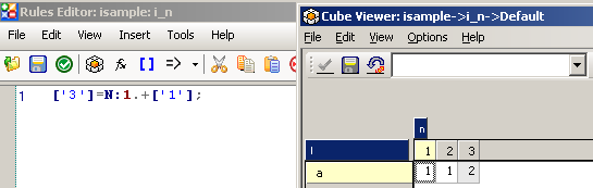

ioscat
Posts: 209
OLAP Product: Contributor
Version: 9.5.2 10.1.1 10.2
Excel Version: 07+10+13
Re: What does this rule mean?
Post by ioscat »

Whats the different with add "." behind the "1" or not?
qml
Posts: 1098
Excel Version: 2007 - 2016
Location: London, UK, Europe
Post by qml »
kiss351523 wrote:Whats the different with add "." behind the "1" or not?
No difference.
1. = 1 = 1.0 = 1.00 = 1.000
