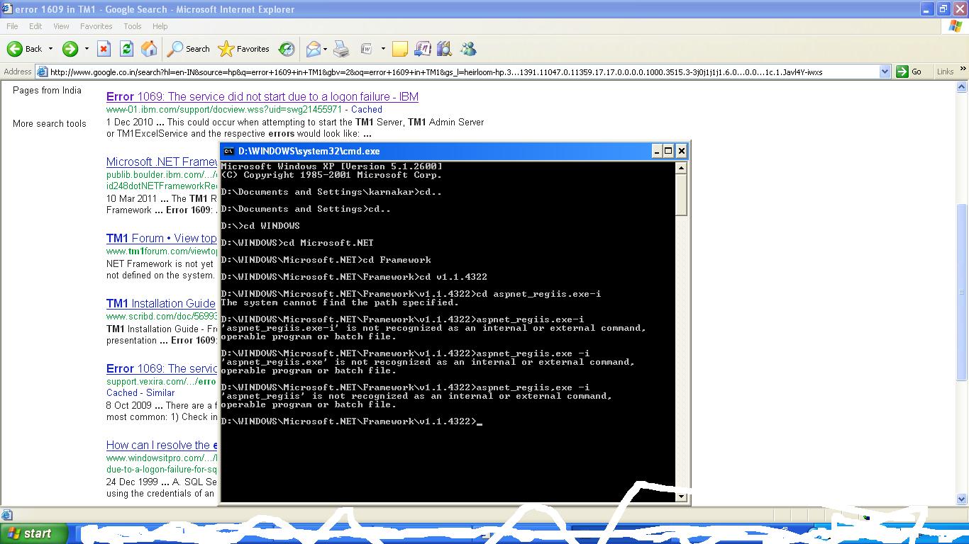

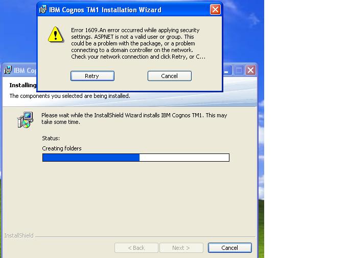

I was trying to install TM1 9.5.2, but I got an error, PFA in below screen shot after getting information for that error i tried to resolve that but i got one more error, for this error i am unable to find any info.

So what have you actually tried? How have you searched for info? I very quick search on either this site or Google will suggest you need to install something. Have you tried this?charan wrote:Hi

Desktop background looks like XP. DId you install IIS before installing TM1?

According to your screenshot you are using the Microsoft .NET Framework Version 1.1.4322
TM1 Web Version 9.5.2 is not using the Microsoft .NET Framework Version 1, it is using the Microsoft .NET Framework Version 3.5 SP1, see the web page listing the TM1 9.5.2 Supported Environments:
http://www-01.ibm.com/support/docview.w ... wg27020888
Cognos TM1 9.5.2 Software Environments
http://www-01.ibm.com/support/docview.w ... 88#tm1_web
The Microsoft .NET Framework Version 3.5 SP1 respectively Microsoft .NET Framework Version 3.5 and Microsoft .NET Framework Version 3.0 are extensions on top of the Microsoft .NET Framework Version 2.
Use the 231 MB big full package of the Microsoft .NET Framework 3.5 SP1 which includes the Microsoft .NET Framework Version 2:
http://www.microsoft.com/en-us/download ... x?id=25150
Microsoft .NET Framework 3.5 Service Pack 1 (Full Package)
After it's install go into the directory "C:\WINDOWS\Microsoft.NET\Framework\v2.0.50727\" to run the executable aspnet_regiis.exe
