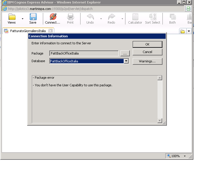

Hi all, I created admin user as a cube with Architect 10.1,
always as Administrator I created a view of the cube with advisor 10.1.
the cube views were generated with the correct user rights (authentication via LDAP).
If I try to open my view with a user who is not an administrator I find an error in the package. (see attached photo).
thanks to all and I am available to every detail

- error.png (28.46 KiB) Viewed 3140 times

First of all I would check whether the user group your user belongs to has access to the Cognos package 'FattBackOfficeItalia'. I think at least 'Execute' and 'Traverse' have to be granted, maybe also 'Read'.
Have you published this package through Framework Manager to Cognos Connection?

hello, thank you very much for your answer,
I published my package from TM1 and I verified that my user has all access corretti.Das what can be given that type of error?
I can not deal with them ...

I do not think you can publish a Cognos package directly from TM1. In Express, you can do it by Framework Manager or you can do it by using the Manager console, using TM1 as native data source. And then, when you published the package to Cognos Connection, you should check whether your group has access to it.
Try to launch Advisor from Cognos Connection, and select the package FattBackOfficeItalia. Does the same error come up?
There is also a Capability assignment in Cognos Administration for EV Studio, only users assigned to this capability can open up Advisor. However, the Everyone group is assigned to this capability by default so I don't think this is your problem right now.
