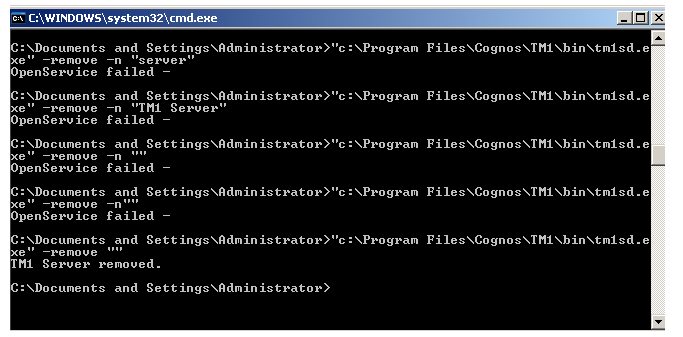

I got server "TM1 server" in services. How to remove it?

i got answer myself, thanks all!

regedit will do the trick.
Re: How to remove server without name from services?
try
sc delete "service name"

regedit is like changing DNA. too dangerous.
