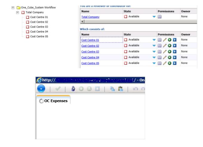

Created Application using Performance Modeler - just one cube-view + Approval Hierarchy
• Lauching using TM1 Application Web (Contributor).
• Assigned Top level access using 'Reviewer Edit' + depth ALL
• Model Opens and displays full Approval Hierarchy correctly
• Individual Node opens but does not display Grid - just name of tab [OC Expenses]
• No error message
• Same model opens correctly in Cognos Insight
• Version 10.1
User/User Group is Admin so already has full Cube access.
Have created additional users/groups and assigned WRITE access at Cube and Dimension level and assigned just submit access to lowest level node.
Always the same result. Does not display grid.
I have attached a screen print showing problem.
Thanks all.
Mark H

- open_node_blank_screen.JPG (29.16 KiB) Viewed 8048 times

Once more this Forum has provided me with the answer or the inspiration to find the answer.
I was accessing the Admin Server directly using remote desktop where i was experiencing a duplicate authentication process. One was wanting my windows Id instead of the plain TM1 authentication. Server side using IE 9.
Whilst investigating the IE versions i tried accessing from my desktop (using IE 8) i did not have dual authentication and node opened correctly.
Now investigating the authentication set up.
