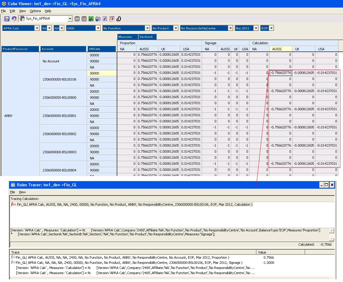

As attached, I managed to find some calculated values via zero level elements, so it looks like the rule calculation is working, however it is not being fed correctly (also confirmed by Check Feeders) :(

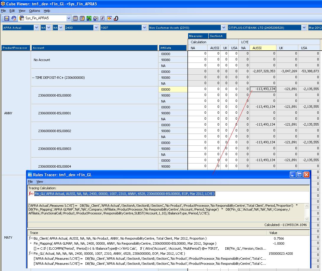

thanks again for the tips, am finally getting somewhere :) ...have taken the advice and combined everything into 1 rule formula
ie [APRA Actual] = [Proportion] x [Signage] x [Balance]
(where Proportion and Signage come from external cubes and Balance is internal)
...this seems to be returning a result when zeroes are unsuppressed, so looks like am having an issue with the feeders again - i suspect because the !Account is attribute calculated the feeder may need adjusting, or the rule rewritten in a different way...
Matt
['APRA Actual',Measures:'LCYE'] = N:
   DB('Biz_Client','APRA Actual',!SectionA,!SectionB,!SectionC,'No Product',!ProductProcessor,'No ResponsibilityCentre','Total Client',!Period,'Proportion')
   DB('Fin_Mapping','APRA GLMAP','NA','NA',!Company,!Affiliate,!ProductProcessor,'No ResponsibilityCentre',!Account,!Period,'Signage')
   DB('Fin_GL','Actual','NA','NA','NA',!Company,!Affiliate,!FunctionalCell,!Product,!ProductProcessor,!ResponsibilityCentre,SUBST(!Account,1,10),!BalanceType,!Period,'LCYE');
FEEDERS;
['Actual',SectionA:'NA',SectionB:'NA',SectionC:'NA',Measures:'LCYE']=>['APRA Actual',Measures:'LCYE'];
