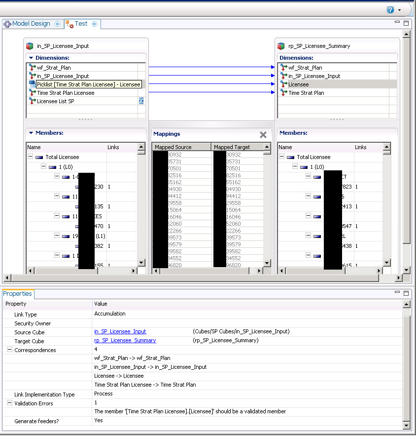

Re: TM1 Link in Performance Modeler giving Validation error
Thanks for the replies.
I have tried removing the picklist and then adding it back. That didn't help.
Screenshot showing the issue:
- 8-22-2012 2-41-25 PM.jpg (181.53 KiB) Viewed 11080 times

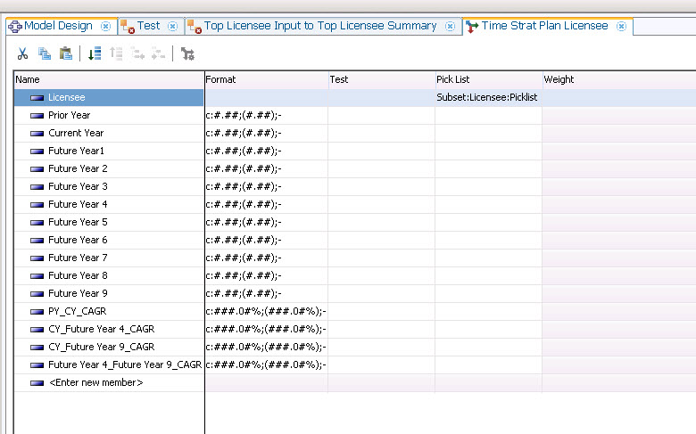

Show me the content of the dimension containing the picklist (Time Strat Plan Licensee) using the dimension editor (double click the dim in PM)
jbcraigs
- Posts: 24
- Joined: Thu Nov 11, 2010 4:38 am
- Version: 9.5.1
Screenshot showing the contents of 'Time Strat Plan Licensee' is attached.
- 8-23-2012 2-37-472 PM.jpg (86.79 KiB) Viewed 11053 times
