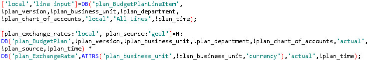

Made this rule formatter as TextPad add in.
you may find TextPad here http://www.textpad.com
From:
From Rule
From Rule
from rule.jpg (53.68 KiB) Viewed 12653 times

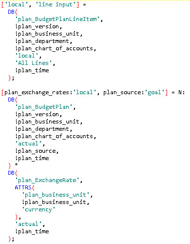

To:
To Rule
To Rule
to rule.jpg (63.47 KiB) Viewed 12653 times
