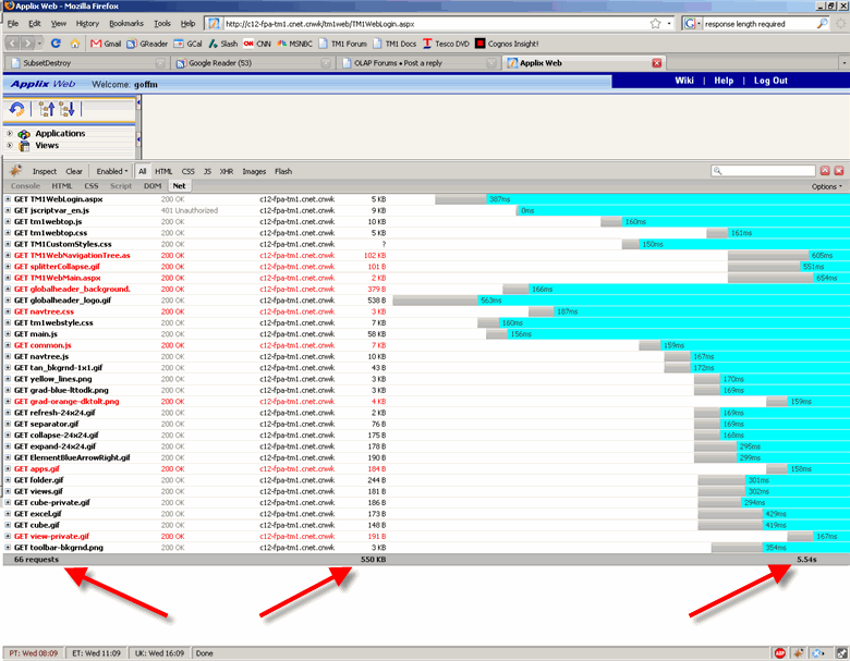

After playing around for an hour or so this morning, I highly recommend anyone using TM1 Web take a look at Firefox 3.0. The rendering engine has been significantly improved, and I find websheet performance to be dramatically faster.
Anyway, here are the results of my testing with Firebug. The xls template is 421 KB. The server is in San Francisco, and I'm in London. Note: times below are response + transfer times (per Firebug)-- rendering is additional and unmeasured.
  • Initial login to TM1 and loading frames/topbar/navbar: 5.54 seconds for 550 KB.
  • First load of the template: 3.74 seconds for 1.02 MB.
  • Closing and reopening the websheet: 2.18 seconds for 646 KB.
  • Changing a SUBNM linked by all DBRWs: 0.22 seconds for 635 KB.
