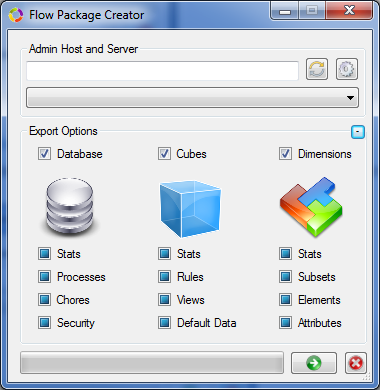

You can limit the object included in the snapshot file in a few different ways. The first is to expand the Database/Cube/Dimension options in the snapshot creator screen. This will filter by object type and various other properties.

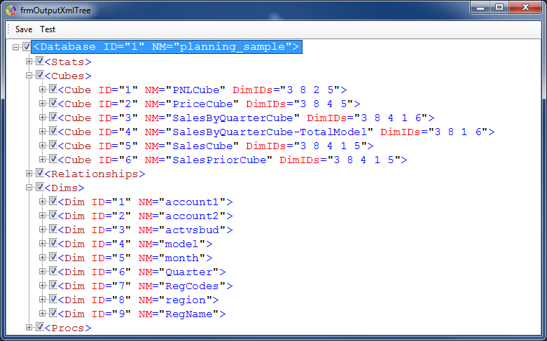

Once the snapshot creator has completed, you get an xml view of the data returned. Within this screen, you can turn on and off particular nodes in the xml using the checkboxes to the left of the text. In this way, you can exclude entire cubes, dimensions, or any combination that makes sense.
