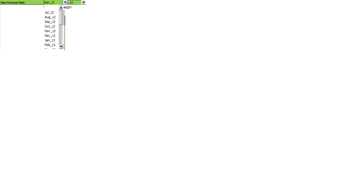

Hi Guys,
I have designed an application in active form and it's hosted over TM1 Web. Everything is OK at active form level and works fine. But I notice that the pick-list is not working appropriately at TM1 web to input value 'by selection' into the desired cell. The error what I get on selecting the cell is '#REF!'
The first column-cell shows me a drop-down box with all picklist values BUT next to this cell, till end of the grid area, all cells displays ONLY '#Ref!' in a drop-down box.
The screen cut is attached.
Did you guys came across to such issue ?Would you suggest me work around ?

What is the formula in those cells that are coming back with #Ref? Are they valid?olap_knk wrote:The first column-cell shows me a drop-down box with all picklist values BUT next to this cell, till end of the grid area, all cells displays ONLY '#Ref!' in a drop-down box.

The formula in 1st column at excel is
=DBRW("ServerName:lookup_CubeName",D$15,"New Forecast Date")
In 2nd column at excel is
=DBRW("ServerName:lookup_CubeName",E$15,"New Forecast Date")
In 3rd column at excel is
=DBRW("ServerName:lookup_CubeName",F$15,"New Forecast Date")
and goes on....
On excel I can see these working but on web except 1st column all shows '#REF!' in dropdown list.
'New forecast date' - is an element (string) of the measure dimension which has attribute (Picklist) months.
D$15/E$15/F$15/ - Is excel cell reference value which holds the item name.
The planning cube has a rule attached which calculates values on inputting new forecast date in lookup_cubename

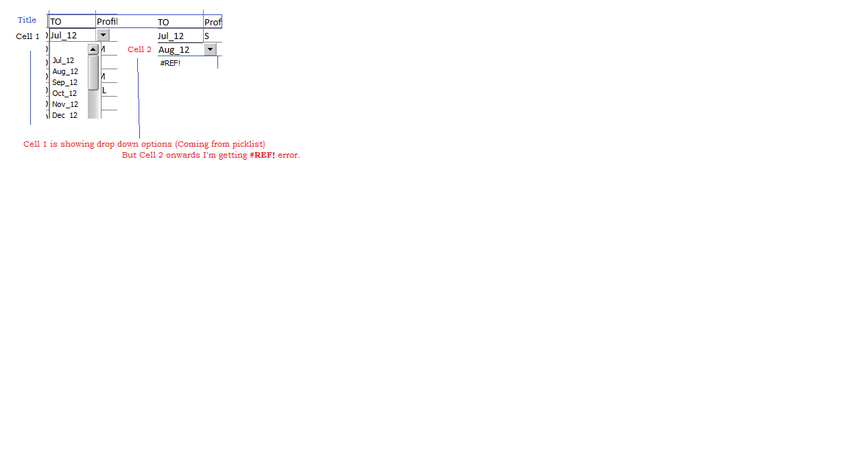

Something is going wrong at TM1 software Picklist functionality on web. Though I have changed all DBRW to DBR.
I tried designing a very simple .xlsx doc with cell input TM1 Picklist instead of excel 'list' option but could not see any improvement. I can see only '#Ref'!' as option in each input list cells at excel. (Only the top 1st cells shows associated list options) . Attached screenshot for reference.
What it appears to me is -
- Error_REF_Picklist.png (21.67 KiB) Viewed 9266 times

You can resolve this issue by highlighting all the cells that have a DBR or DBRW reference that relates to a picklist and then removing Excels data validation from the TM1 picklist reference to "Any Value".
If you then save and republish your sheet back to TM1 then the #REFs will go away in the web.
