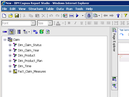

Yes, I know how i can use dimension element's alias as caption instead of dimension element's invariant name in BI.
My problem is: I see the dimension name in Report Studio's source pane instead of dimension caption.

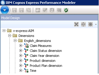

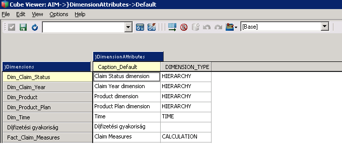

I have attached three pictures:
@PerformanceModeler_DimensionCaption: You can see my dimensions at the Performance Modeler. PM shows the caption of dimension.
@DimensionAttributes_ControlCube: You can see Dimension Attributes control cube where I defined the captions for the dimensions.
@ReportStudio_DimensionName: You can see Report Studio shows dimension's name instead of dimension's caption and this is my problem.
Thx again for reply!
