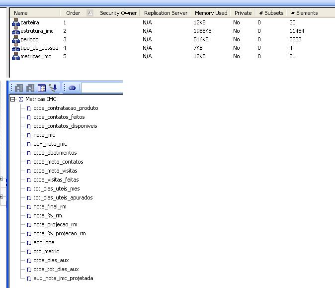

Can you suggest anything? I attached the dimension properties and the rule code, to make this problem more visible.

- cube dimensions and Measures detail
- dimensions.JPG (46.54 KiB) Viewed 6371 times

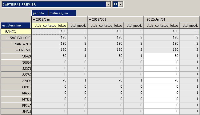

Everything's fine (calculation time, reports), except that 'qtd_metric' gives me 2 as result of the test, instead of 10, as expected:
Is there a way to keep the old behaviour ( "1" for each member) without having the impact I used to have?
