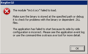

I have installed the TM1 10.1 client on a server with the following specs, and continue to get the run time error "File not found: tm1xl.ocx" when I run the client. I believe I have read every post about this file on this forum, etc.
Installing the client on Server 2008 R2, fully patched. Excel (Office Standard) 2010, patched. C++ 2005 Redistributable installed (have also uninstalled C++ 2008 per forum comments). This is also a Terminal Server.
When I installed the client, I was logged in as Administrator, and also selected "Run as Administrator". Everything I find points to registering tm1xl.ocx.
When I try and register the tm1xl.ocx file, I get the attached error.
Error when registering tm1xl.ocx
Screen shot 2012-07-26 at 3.17.03 PM.png (8.73 KiB) Viewed 9846 times
Any help is appreciated.

Side-by-side errors mean that you are missing a specific version of something. This may be a version that is older than the one that you have installed. If you look in the windows Application event log you will find an entry for this error and it will tell you the package and the exact version of it that it is expecting. You will need to install that particular version, which if it's a windows distributable, you can generally find by searching for the version number in a popular web search engine.

Thanks for the reply Duncan. Here is the Application Log Event Data. Can you offer any more wisdom?
Activation context generation failed for "C:\Program Files (x86)\IBM\Cognos Express Clients\Xcelerator Client\bin\tm1xl.ocx". Dependent Assembly Microsoft.VC80.MFC,processorArchitecture="x86",publicKeyToken="1fc8b3b9a1e18e3b",type="win32",version="8.0.50727.762" could not be found. Please use sxstrace.exe for detailed diagnosis.

joeainsworth wrote: Microsoft.VC80.MFC
This is Microsoft Visual C++ version 8 (AKA 2005) Microsoft Foundation Classes.
joeainsworth wrote:version="8.0.50727.762"
This is the exact version number.
Searching for this (8.0.50727.762) gave http://www.microsoft.com/en-us/download ... px?id=5638 for Visual C++ 2005 SP1 as the first result. Download and install the package and see if that fixes your problem.

Duncan,
It appears you have helped me out! I did install C++ 2005, but did not have SP1. I did that install via Windows updates and no longer have the error.
