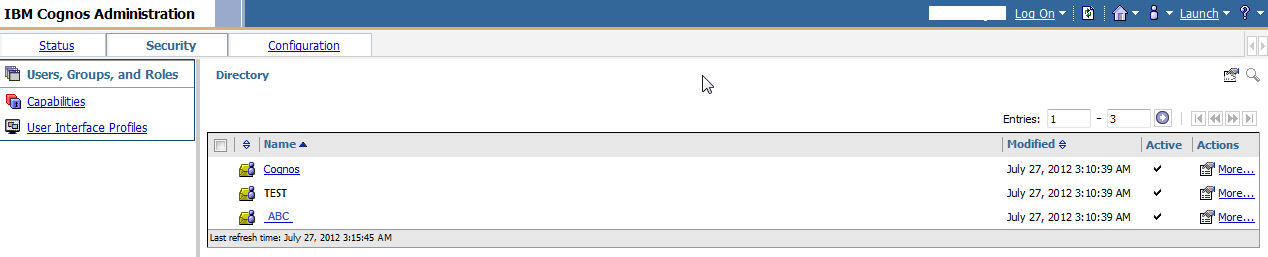

We are currently using Cognos 8 to handle authentication in TM1 9.5.2 and we are authenticating against our local domain controller. However, we have merged with a new company and we need to find a way to let these new users access our contributor applications. We have connected our networks between the two companies but our domains haven't been consolidated yet. I would like to add another security resource in Cognos 8 to look for the new company's domain controller so we can setup security for these users.
So far, I rwent into Cognos Configuration and created a new resource with the namespace, host:port, etc. I ran the test on the new namespace and it connected just fine. Then I saved the config and restarted the cognos service. Now when I go into Cognos 8 to administer security groups, I can see the new namespace but I'm unable to see any of their users/groups. Its basically showing the namespace without a hyperlink. I'm still able to click on my previously setup namespace and the default cognos namespace. At this point, i'm running out of time to get this setup and would really appreciate any advice or direction.

The new "Test" namespace won't let me see any of the contents (users/groups/etc) inside of it. I posted a screenshot that shows the TEST namespace is not even clickable.

That's because you are not authenticated into that namespace. Click on the Logon dropdown on the blue menu bar and log into Test (Just like BigG said).
