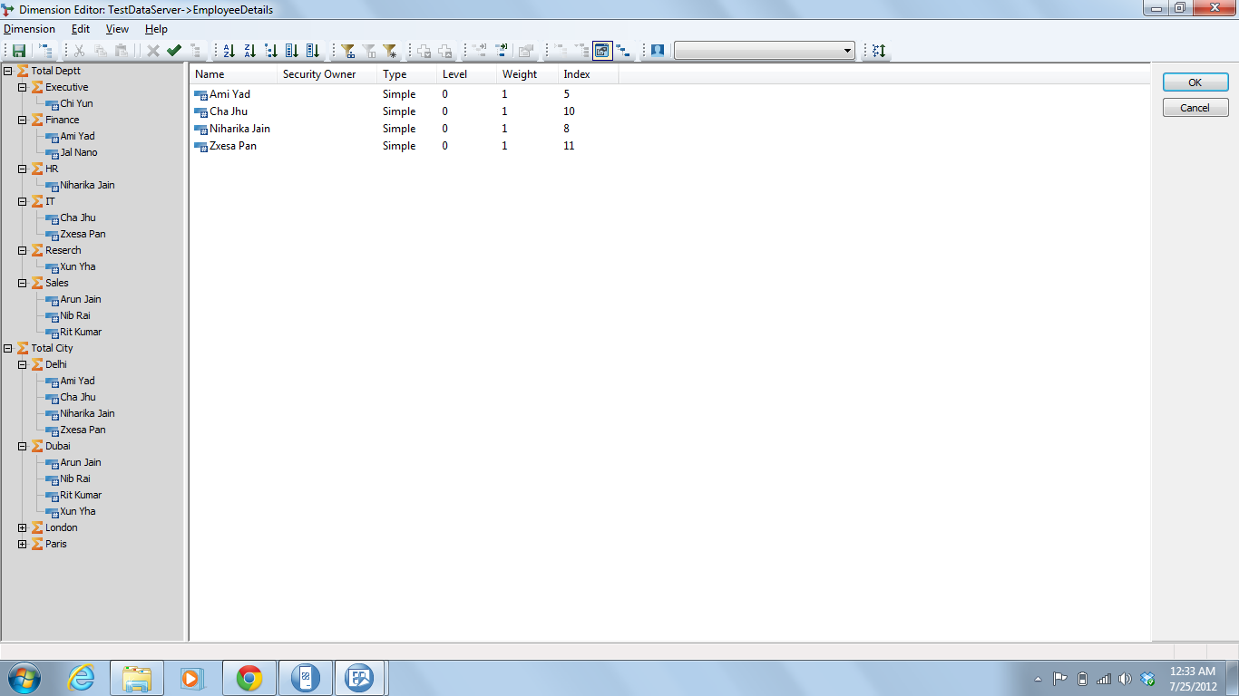

Thanks for the help but, data is anyways in CSV, and is in .excel. Here on the post it is showing like a single line as formatting does not apply on the forum GUI.We do not want to pull it in a single line nor have it in single. Issue is not about pulling data, but the semantics. Please refer to the attached image as it has the contents in excel which needs to form a dimension having levels Employee Name -> Department -> City -> Total Employee
Now if I want to use Dimension Add and then Dimension Component add , it will attach Employee "Jal Nano" and "Ami Yad" to "Finance" under both "Delhi" and "Paris" , so I will have 4 elements for this instead of just two. This is die to many to many relationship between City and Department.
Actual Result (As seen in Dimension Editor in TM1 after execution of TI Scripts)
Delhi --> Finance --> "Jal Nano" and "Ami Yad"
Total Employee ->
Paris --> Finance -->"Jal Nano" and "Ami Yad"
Expected Result
Delhi --> Finance --> "Ami Yad"
Total Employee ->
Total Employee ->
Expected Result
Total Employee ->

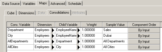

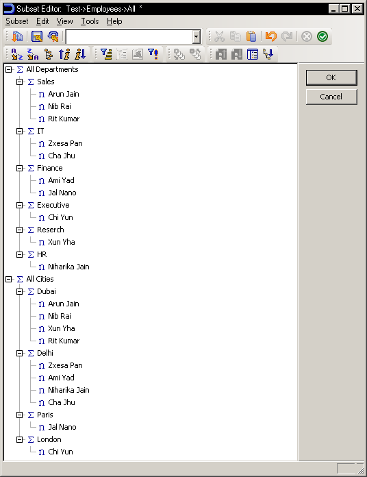

If your employee names are unique then this would appear to be a place for alternate hierarchies in the same dimension. The employee dimension would have two hierarchies, employees by department under the 'All Departments' member, and employees by city under the 'All Cities' member.
To do this in TI set the 'Total Employee' column to ignore and create two new variables on the Variables tab. I called them AllDepartments and AllCities. For the formulae (under the Formula button above) I put the expressions
and
Then on the Consolidations tab I assigned them as below
and then I get the following result
The key to this is in making sure that you have a separate top element for each hierarchy. This will also make it easier to use one or other in a view without confusing the users.
