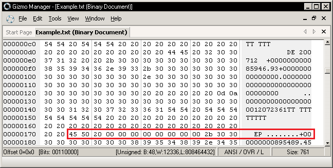

Thanks for the background. I loaded the file in a hex editor and the bytes corresponding to your characters are all 0. This is normally what C programs use to represent the character after the end of a string, and it does not represent a character in any recognised character set. For some reason Word is choosing to use the character "ÿ" to show you instead, but that is Word's choice and has nothing to do with the underlying file.
You can see the section outlined in red in the following picture.
Text file shown in HEX editor
I suggest you find out if it is the same in the .data file and if so go back to the source system that provided it to investigate there. I would be surprised if you could ever get TI to import it properly. It might be worth trying your VBScript search and replace though.
