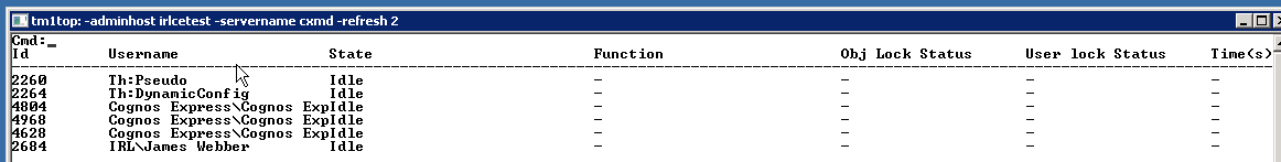

It has been working on both and I know it was working on here is a screenshot of it working on CE 10 in mid June:
Working CETtest.png (8.22 KiB) Viewed 16167 times
Sometime after 6th of July it stopped working on both my CE 10 server and my CE9.5 server which I have not touched.

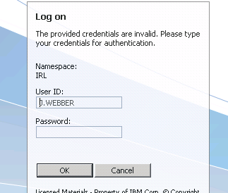

4. Redirects to http://irlcetest:19300/p2pd/servlet/dispatch, Put in known good AD credentials
5. Does not log me in give error:
The provided credentials are invalid. Please type your credentials for authentication.
Tried with IRL\j.webber and other users credentials and does not work.

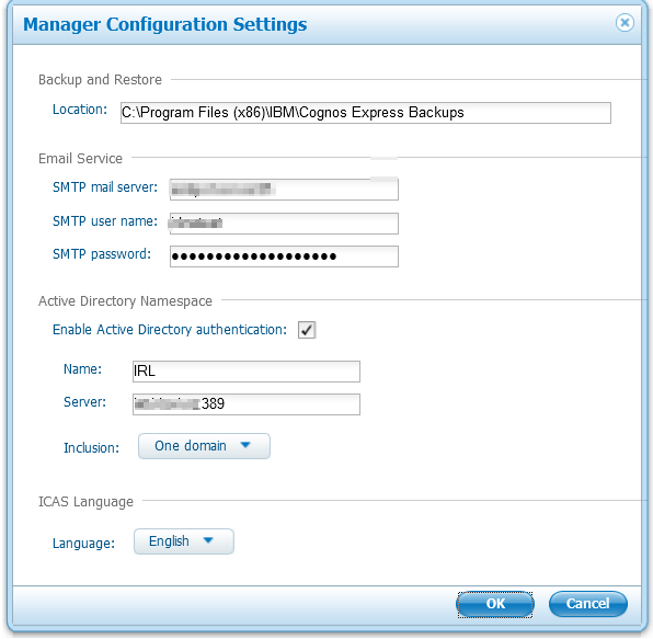

I have setup the AD namespace as per below:
I have also tried <ldap server>:389 and also using the secure ldap port 636.
