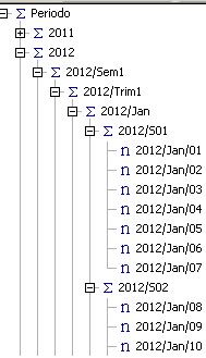

There are 4 dimensions: Period, Accounts, Organization and BU. Attached, there's an example of Periods dimension structure.
This calculation gives me the monthly grades for all organizations. Data is loaded monthly, for the first day of each month.
