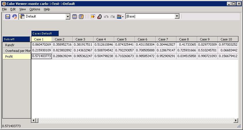

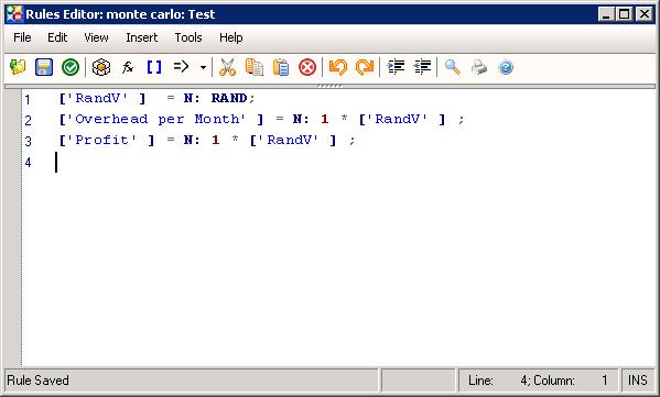

Here are the Screenshots , you can see i have assigned the element 'RandV' Random function and the other elements say is the product of 'RandV' and 1
Eventhough i am multiplying by 1 , all the values are not same. This is where i face the issue.
I hope the issue is defined clearly.
Thanks in advance.
Thanks in advance.

- Posts: 1833
Re: Using Rand(Random) Function
Venki,
I think you are slightly missing the point of rules.
Where you have ['RandV'] =N: Rand; that is calculating it for every case element separately and the random number generated will be different for each one.
Like I said earlier you should probably go down the TI route but if you wanted to do that through a rule I suppose you could do it by having a consolidated element called 'All Cases'.
['RandV']=
If ( Ellev ( 'Cases',!Cases)=1, RAND ,
If ( Ellev ( 'Cases',!Cases) = 0, DB('test', elpar ( 'cases',!cases,1),'RandV'), Continue ) );
The above is very generic and you will need to change it a bit but based on the assumption that your cases dimension only has 2 levels; the "N" level and 1 element consolidating all of them.
It calculates a Random number for the consolidated element and then all the N-level elements below that will equal that number.
Edit - A cleaner way to do this would probably be calculating the random number within a control cube and then dragging that across.

Interesting. It would appear that RandV is being re-evaluated when referenced from Overhead and Profit, which you are quite right is not what should happen! Once RandV is evaluated the value should stay fixed until the calculation cache of the cube is cleared by data entry.

Ah I see, I mis-read the issue and thought you were wanting each case to be the same random value.
I'm not sure it is a bug though, as I understand it when you ask TM1 to calculate a value in rule it will re-evaluate every calculation which that calculation is based on. So although it is quite annoying that it doesn't evaluate in the order you are wanting it to, I'm not sure that would constitute a bug?
That's not my understanding which is the first time the calc engine is asked to evaluate an N rule it will be evaluated as per the rule and the value will be stored in the calculation cache without going back to the rule. On subsequent retrievals of the same cell the value will be retrieved from the cache. This should be what happens until such time as the cache is cleared which would happen either via data entry in the cube or a change somewhere else in the model that is linked via cube dependency.declanr wrote:... as I understand it when you ask TM1 to calculate a value in rule it will re-evaluate every calculation which that calculation is based on. So although it is quite annoying that it doesn't evaluate in the order you are wanting it to, I'm not sure that would constitute a bug?
Maybe as all lines are part of the same view the whole retrieval counts as 1 go? I'd be interested to see if from a fresh start the view contained only RandV and then the other measures were introduced what would happen.
- Posts: 1833
A similar thought had entered my head so I did a quick test to see the results:lotsaram wrote:Maybe as all lines are part of the same view the whole retrieval counts as 1 go? I'd be interested to see if from a fresh start the view contained only RandV and then the other measures were introduced what would happen.
1/ Both values calc'd at the same time = no match
2/ First value calc'd with second value not visible = match
3/ Second value calc'd with first value not visible = no match
Edit - to clarify "First Value" is the "Rand" value whereas "Second Value" simply equals "First Value".

Whether a calculated value is stored in the cache depends on whether the evaluation of it took more than CalculationThresholdForStorage (http://publib.boulder.ibm.com/infocente ... orage.html) steps. If you set this parameter to 1 in TM1S.CFG then your calculations will match the RandV. However your memory use will probably be higher as all calculated values will the stored, instead of only the expensive ones. Unfortunately this parameter applies uniformly across the whole server.lotsaram wrote:it will be evaluated as per the rule and the value will be stored in the calculation cache without going back to the rule
