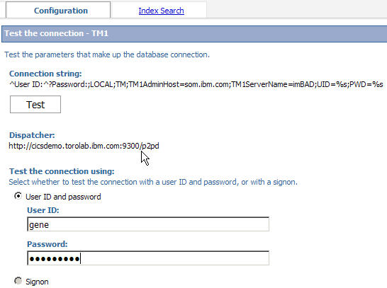

However when I create a new "IBM Cognos TM1" connection within Cognos Administration, no matter what I try, the test connection fails with a message:
http://mydispatcher:9300/p2pd IBM Cognos TM1 / Dynamic Failed XQE-DS-0006 Unable to logon to the data source.
Creating a signon or typing in my userid/password doesn't work either. The following connection string is shown by Cognos Administrator:
^User ID:^?Password:;LOCAL;TM;TM1AdminHost=MYADMINHOST.com;TM1ServerName=MYSERVER;UID=%s;PWD=%s
So for some reason the userid/password combo used in Cognos BI 10.1 connection is not being passed correctly to TM1 9.5.2. Perhaps the name of the TM1 "namespace" has to be passed as part of connection string? Something else?

Thanks, but I am not sure I got the answer from the posted URLs.
The first one seems to deal with the case where TM1 and other Cognos BI applications are all in the same Cognos BI "instance".
In my case TM1 server is hosted in a different/separate BI "instance".
The attached snapshot shows the connection page that I created in my Cognos Connections.
