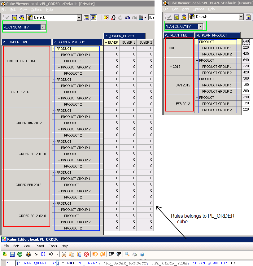

I understand that above formula for measure 'plan quantity' returns only zeros into order cube, because time dimension member names do not match between plan and order cubes. How to solve this problem? Is there anyway I can add prefix into above formula like "ORDER" prefix? See attached picture of simple sample of order and plan cube.

- cubes.png (38.6 KiB) Viewed 2639 times

- Yes you can use a prefix
instead of !order time you can put 'ORDER ' | !order time
Keep in mind that you would need to get rid of the 'order' part in your feeder though. So when feeding from the other cube you will need to use a subst function to get rid of the order part.
- Another option would be to create aliases on both dimensions. (Which is a solution I would personally prefer)
Jeroen
