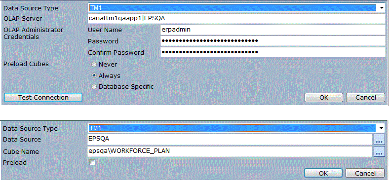

Regarding the Preload Checkbox for Cube Databases in EV, this option is not selected, but on the datasource object on EV Server, for Preload Cubes option, we have selected "Always", and we were told that with this option you don't have to specify the Preload Option for each cube.
Do you think that we should change that?
I'm trying to post a screenshot here, but I don't know if it will work or not:)

I can't see that there is any harm having preload checked for each cube even if you have "always preload" already selected for the data source but if EV does what it says on the tin then this is probably unlikely to solve your issue. It really sounds like when EV checks the metadata timestamp it believes that the copy EV is holding from the preload is out of date based on the timestamp received from the data source. So are you really 100% certain that there has been no security change or metadata change affecting the dimension since the preload? (this might include changes to public subsets as well as dimension structure and possibly any security refresh operation not just DimensionElementSecurityPut).
