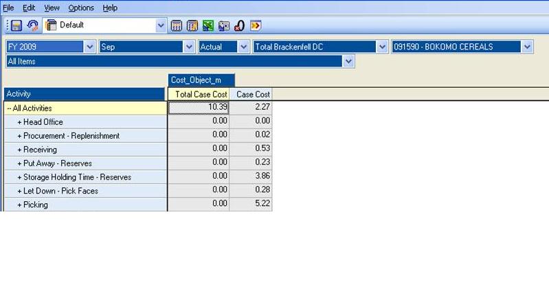

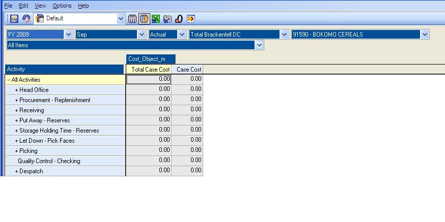

Here are the 2 screenshots they sent me. Maybe this may help.
- User2.JPG (50.36 KiB) Viewed 10203 times
- User1.JPG (42.79 KiB) Viewed 10204 times

Not that this SHOULD matter, but I note that one has automatic calculation on and the other doesn't. (It's the only difference that I can see between the two, though I can't see the title bar.) It'd be interesting to see whether they get the same result if they turn auto recalc off.par3 wrote:Here are the 2 screenshots they sent me. Maybe this may help.

Maybe you have some kind or problem with alias that are out of sync?
One shot shows 91590 and the other 091590, so the two views may not be looking at the same bit of the cube?
Cheers

Ooops, missed that one. That's what I get for posting while lying in bed not getting any sleep with a dose of 'flu.Steve Rowe wrote:Maybe you have some kind or problem with alias that are out of sync?
One does wonder how it would be possible for the same view to use two different aliases...

Do you have 2 elements of one called 091590 - Bokomo Cereals and the other 91590 - Bokomo Cereals. See if the user that can not see the numbers can see both elements?

its the cereals selection, they are not the same. there must be 2 elements, one with the leading zero and one without. i've had the same issue with clock numbers for employees, i ended up using a different unique identifier because of all the issues it caused.
