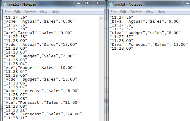

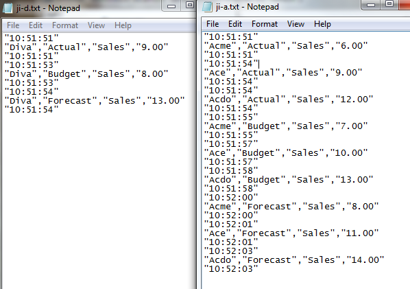

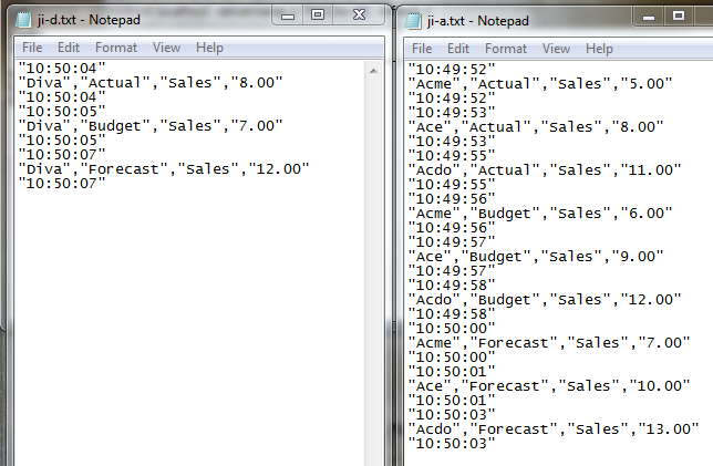

Here are the outputs when the write operation is included which show synchronous activity:-
And here are the outputs when the write operation is NOT included which show asynchronous activity:-

What a phaf! I now get asynchronous results as shown below:-
