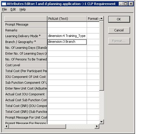

Can you screenshot your attributes dialog so we can see the name of the attribute and how you've setup the PickList string?

I have tried all the three types of Picklist. irrespective of the type of picklists, the result is same.
Even i have tried defining the picklist in the Picklist_cube.
Attributes
Attributes
Kindly find the attached image file whre i have defined the Picklist.
