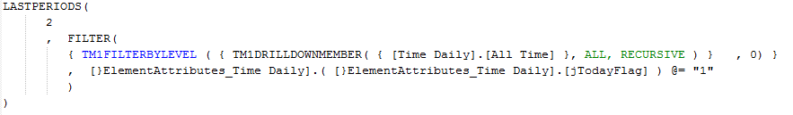

I have been playing with MDX to try and understand if it is possible to make dynamic time based filters to say create a subset containing the last few days. MDX seems to have no concept of now() or today() so for this excercise I have added a rule based flag to a time dimension that denotes today as you can see below:-
I can create a filter that makes a subset that contains just this element:-
However my question is can I use this in any way to create a subset that retrieves the last few days using something like the attempt below:-
I know there are many ways to create such a subset using rules/TI Etc. but I really wanted to see if this was possible with MDX. Any hints or tips would be most gratefully recieved.

your MDX request fail because LASTPERIODS function expect a member in second argument and FILTER function return a set.
You need to transform the result with TM1Member to return a valid member expression:
LASTPERIODS( 2,
TM1Member( { FILTER( ... )}.Item(0), 0)
You could probably also use Nick solution with a rule based on date numeric identifiers.

Thanks I had tried that but dont seem to be able to make it work even with a straight forward statement such as:-
TM1MEMBER( { [2012-04-19] }.item(0), 0)
Re: Acedemic exercise to understand MDX
Posted: Thu Apr 19, 2012 1:18 pm
by AmbPin
Oh I see, TM1MEMBER( { [2012-04-19] }.item(0), 0) doesnt work on its own but does in the lastperiods(2, TM1MEMBER( { [2012-04-19] }.item(0), 0))
Thanks very much
