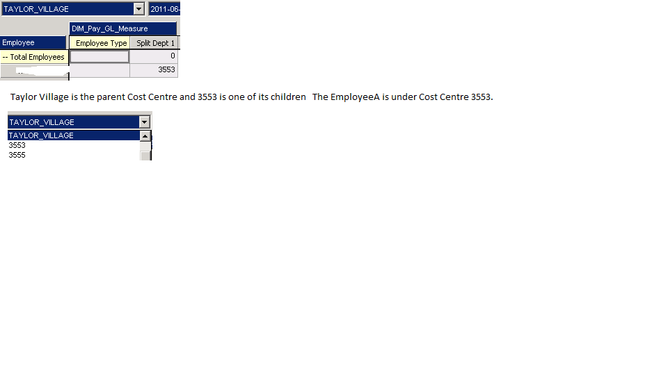

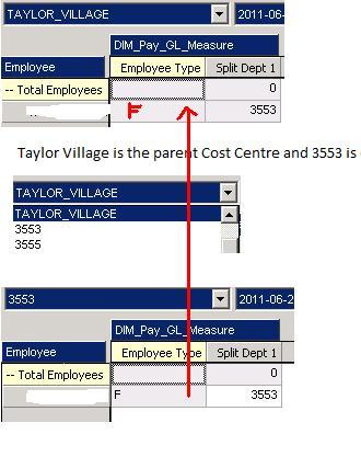

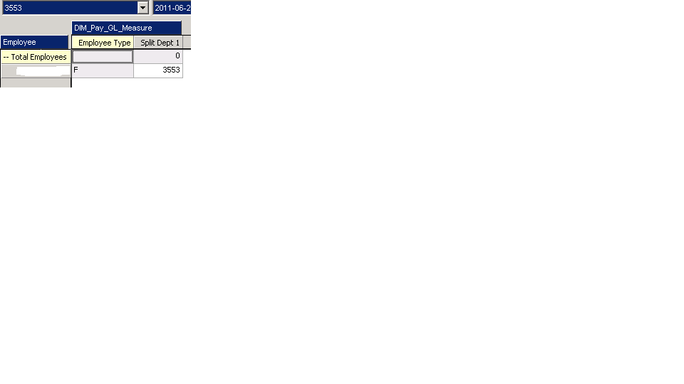

Thanks for all your replies. Here are the screenshots:
- Parent screenshot.png (14.62 KiB) Viewed 8154 times
- Leaf screenshot.png (11.19 KiB) Viewed 8154 times

So are you expecting to see this then?
This won't happen because text information won't get consolidated, as lotsaram and myself have outlined above.
What you could do is load the gender against the employee as an attribute then write a rule that says
['Employee Type'] = S: attrs('Employee', !Employee, 'Gender');
Though I'm not sure that really makes a lot of sense to repeat the information all the time. The other option is make "F" and "M" consolidations in the Employee dimension.
Martin
