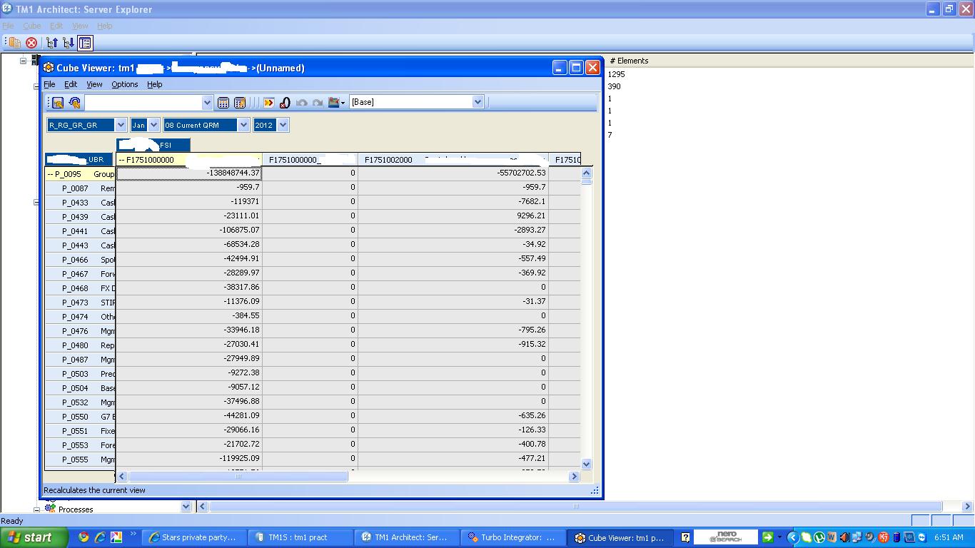

find the attachments for the cubes

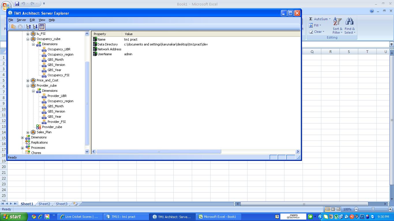

Re: Rule from different dimension with same elements.
cube2
- cube2.JPG (122.46 KiB) Viewed 14604 times

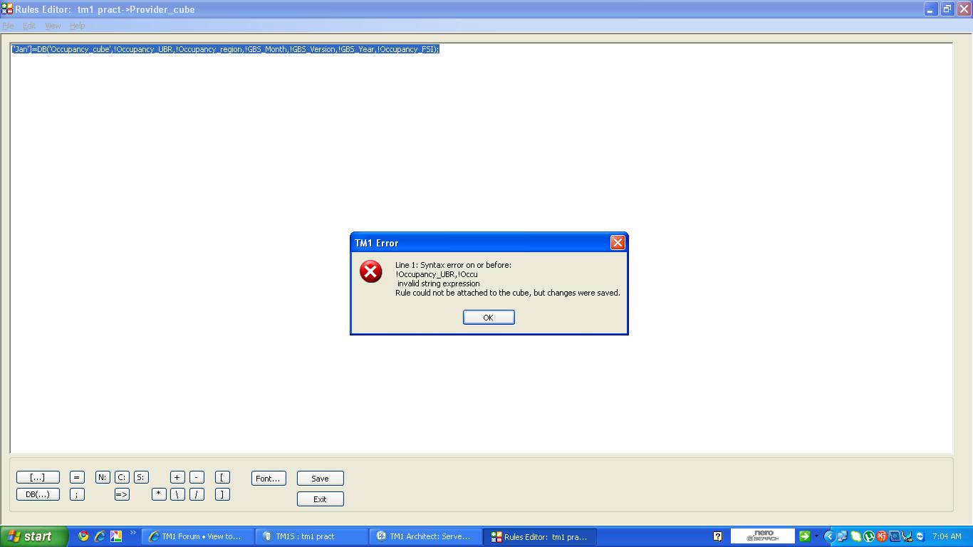

but still it is giving an error the dimension you see in the occupancy cube are same in provider but it is named after provider_UBR and Provider_FSI,the only difference is elements are more in occupancy cube.
After writing the rule the error is, find the attachment,
When you write a rule using the DB function all the following conditions must be met:
1) A value must be provided for all the parameters (the cube name and an element from each dimension, or variable that resolves to an element from each dimension)
2) If you use a variable (with the ! notation) that dimension must exist in the cube the rule is being written in.
It appears as if you have violated both conditions.
Read my post again. Did I say anything about hard-coding anything? When you denote a dimension element with the syntax !DimName then that is not hard-coding, that is a variable that says "plug in the relative element". However, when you use the !DimName syntax, the DimName portion of the formula has to exist in the cube you are writing the rule in. Comprende? Not only that, but you have to provide a parameter for every dimension in the cube and in the exact same order as the dimension exist in the cube!
Writing this rule:
['Jan'}=DB('Occupancy_cube','Occupancy_UBR,!Occupancy_region,!GBS_month,!GBS_Version,!GBS_Year,!Occupany_FSI');
for the Provider cube is invalid because the Occupancy_UBR, Occupancy__region and Occupancy_FSI dimensions don't exist in the Provider cube. Also, whatever happened to the Accounts dimension you mentioned in the first post????
You should substitute "Provider_" everywhere in the rule where you have "Occupancy_" for starters. Whether that will solve you problem is anyone's guess considering the fragmented and fractured nature of this god-forsaken thread. 17 posts for something that could have been solved in 2 must be some sort of record.
Writing this rule:
