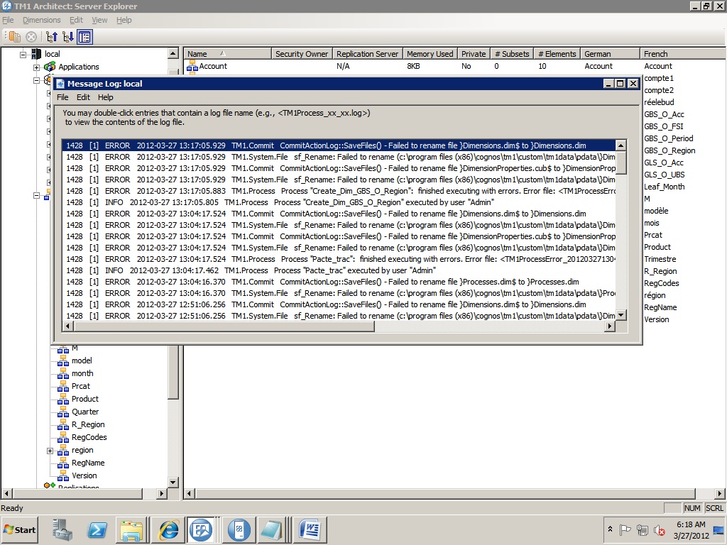

i have an error in TI which is error for failed to rename.find the attachment.help me in this
thanks and regards
tm1 9.5.2
excel 2007
Failed to rename in TI_Process

Re: Failed to rename in TI_Process

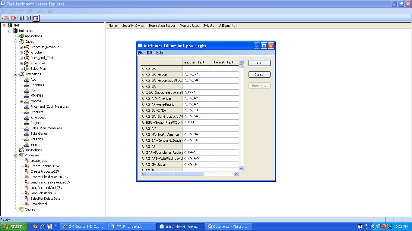

the error was because both parent and child are in same codes, i have changed now it is succesful but one more issue,i have given attribute for child element,
why i have given attribute to child because child element has description.
The attribute is showing when we open the dimension with element attribute.
But when selecting alias in the subset editor, the alias is not displayed.The process is succesful
Find the attachment.

Your attribute 'another' is a text attribute, not an alias, so it will not show up on the list of available aliases in Subset Editor.
