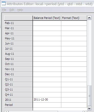

I have tried doing as per your method. But its taking a long time to open the cube view after the rule creation.I am somewhat new to TM1. Can you please validate if the method is correct or not.
I have tested it in my local server. I am just trying do only for the element 2011, for which I have created the 'balance period' attribute and entered the value '2011-12-30'
My Cube name is : gdi_sgf_new
Measure dimension is : gdi_sgf_new_measures
Measure element name is Monthly_PA_LFA (which is marked as X using the 'Marker' attribute)
Period dimension : period(ytd-qtd-mtd-wtd)
Period element for which I am testing is 2011
I have given the same attribute names as you mentioned.

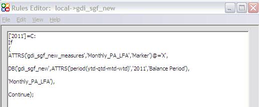

My rule is as given below
['2011']=C:
If
ATTRS('gdi_sgf_new_measures','Monthly_PA_LFA','Marker')@='X',
DB('gdi_sgf_new',ATTRS('period(ytd-qtd-mtd-wtd)','2011','Balance Period'),
'Monthly_PA_LFA'),
Continue);
I am also attaching the attribute dimension details. Please validate them and let me know if anything need to changed to make the cube up and running.

Adding a rule to any cube will slow it down as it will turn the default sparsity algorithm of TM1 off for that cube. To switch it back on add "SKIPCHECK;" as the first line in your rules (you can also add "FEEDERS;" as the last line in your rules for the future). This should restore good performance.
Also, please search for these keywords on this forum or in the TM1 documentation to learn more on this subject, as it's well worth it!

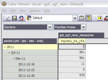

I have added skipcheck and feeders to the rule. Now the cube is opening, but the element value for which I am testing is showing zero. However Its lower level elements are showing values.
My rule is given below
SKIPCHECK ;
[{'2011'}]=C:
If
'Monthly_PA_LFA'),
Continue);
FEEDERS;
['Monthly_PA_LFA']=>['2011'];
I am also attaching the cube view.
Please note. I have also added a Week ending values to the period dimension. Now the hierarchy is Year --> Quarter --> Month --> Week endings
- Cube View.jpg (23.17 KiB) Viewed 11276 times

Re-Look at your DB Statement, it appears to be missing some arguments.
Word of Advice. You are unlikely to always get a full solution on these forums when asking questions. Some elements of independent research/reading of rule guides/reference guides is expected. As QML also suggested regarding Skipcheck & Feeders. I woudl suggest to look at the Rules Guide for the DB Statement.

Probably a bit more advanced, but you do not need the following feeder:
As you are putting a value into 2011 which is the same as one of the children of 2011 (2011-12-30) the Rule is self feeding. Besides you can never trully feed a consolidation element. With the feeder that you have put in you are in effect saying: whereever there is a value against 'Monthly_PA_LFA' then expect a value to appear in any of the "NODAL" children of 2011 which is inefficient and redundant.
['Monthly_PA_LFA']=>['2011'];Always Open to Opportunities

DB('Reservation_Cube', !MKT_FlightNUM, !OperatingFlight, !Flown_Status, ATTRS('Reservation_Date','2014','Balance'),
'Cal Actual Seat'),Continue);
Guys, Please help me on this
