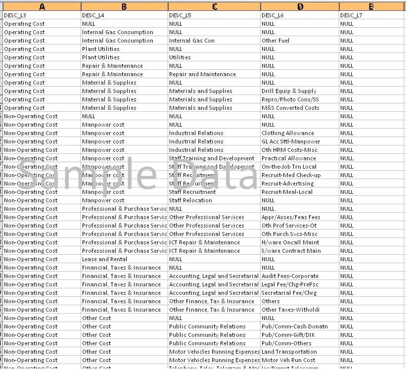

Refer to the image below (data received in.csv file)
Can somebody help me on how to create a subset called 'CostElement' and later insert 2 subsets (Operating Cost and Non-Operating Cost).
For Operating Cost, the should be 4 subsets (Internal Gas Consumption, Plant Utilities, Repair & Maintenance, Material & Supplies)
For Plant Utilities and 'Repair & maintenance', each have one element but for 'Internal Gas Consumption' and 'Material & Supplies', there are still another consolidation then only elements.
The file that i received is in .csv format.
The other concern is; as the above figure, the elements mostly ends at row DESC_L6. There are also possibility that they may have more elements to be added later.
Please help as i am very new to TI programming.
Thank you.
Thank you.

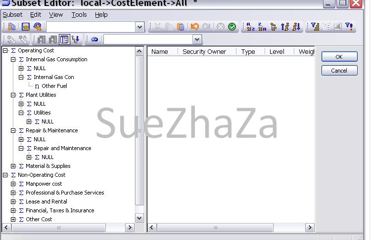

tried the code.. the error occurs only on the last loop on on the last relationship. happens before. not sure why.
attached is the output of the coding... it stills pickup the 'NULL's as element.
DimensionElementComponentAdd(sDimName, sParent, sChild, nElWeight);attached is the output of the coding... it stills pickup the 'NULL's as element.
- The Output
- output1.JPG (55.21 KiB) Viewed 16920 times

The Scan function is case sensitive, so replace Null in Steve's code with NULL, clear out your dimension and run the code again.

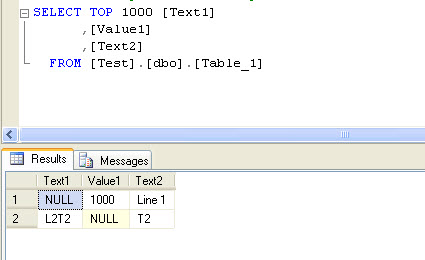

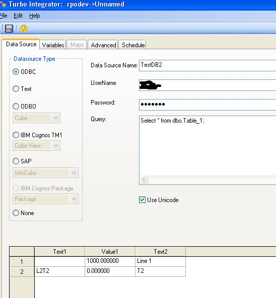

It's worth bearing in mind that you can't actually get a "null" in a feed to TM1. Null is essentially a relational database concept. Null isn't an empty string (for text fields) and nor is it zero (for numeric fields) it is, in fact, a void; an undefined value. In SQL, Null has been described as something which "sucks the life out of" a value since when you perform any operation against a null field you get... null.SueZhaZa wrote:Thanks Alan!
Great Help!!!![]()
btw.. just wondering, what if the 'NULL' (a string NULL) is a real null value (real blank)... scan doesnt work anymore right?
However you can't get real, genuine nulls in an interface to T.I. because it accepts only two data types; strings and numerics. A null which is being fed to a string variable must be reinterpreted as an empty string, and a null which is being fed to a numeric variable must be reinterpreted as a zero.
However your feed is one step removed from a direct feed from the database anyway; it's a .csv, which is by definition pure text. Any nulls need to be converted by the database before it can write such a file. The conversion of a null will typically be to an "empty" field; one where there is nothing between two of the commas. (Not always, of course; in your case the database appears to be converting it to the explicit word "NULL" so that you can identify it as such.)
Although a .csv file is completely text some of the columns, ones which contain text which is in numeric format, can be fed to numeric variables in TI. If a row contains a zero length string, meaning that the file looks something like this, say:
FirstStringField,NumericField,SecondStringField,ThirdStringField
Description,100,Line1,MoreText
AnotherDesc,,Line2,NumericEmptyHere
ThirdDesc,500,,SecondStringEmptyHere
OneLastDesc,970,Line4,YetMoreTextAgain(As an aside, Line2 will be OK if the numeric field is empty as shown above; if it contains text there won't be a conversion to 0, it will instead throw an error.)
However your question is closer to the situation on line 3, where the SecondStringField value is empty. In such a case, yes, the value that comes through into the TI variable will be the equivalent of '' and you're quite correct that such a value can't be used in a Scan.

actually the .csv files is for testing purposes..
i just discover that the real procedure is DIRECTLY from SQL server... with a void, null value (neither string or numeric and yeah as what u explained earlier...)..
from what i understand the SQL server will show 'NULL' for void when doing query in SQL...
and once converted to .csv it will convert from void null to text 'NULL'.
if i'm to test the .csv, by leaving the cell blank, would it be similar to void?
vain, childish, talkative, dreamy, lazy, friendly, warm, lively, busy, complicated, bubbly, moody, kind, cruel, playful, irritating, forgetful, ironic, loud, open, protective, supportive, freak, rebellious, assertive - unique. like everyone else .exe
- Posts: 6672
Re: Need Help
Not exactly. By default when you run a query in SQL Server Management Studio, then any null fields will display with the word "Null". Similarly if you run the query to either Text or to a File (probably the source of your original .csv) then again the word NULL will be displayed, as you've found. There may be a way to override this (other than the obvious one of embedding a Convert command in the original SQL) but I don't know it because to be honest I've never wanted it any other way.SueZhaZa wrote:actually the .csv files is for testing purposes..![]()
However when you use an ODBC connection to pull the same query into TI, the process is smart enough to convert nulls to zero length strings or zero, as the case may be:
- Posts: 6672
Re: Need Help
Oh, and for the sake of penance for omitting the "obvious" option above (and also because I'm feeling bored at the moment) I'll add that it's the Coalesce function that you can use to generate the output from SQL Server without the word Null. For instance, the code mentioned in the previous post will return zeros and empty strings straight out of SQL server, not just at the TI interface, if coded like this:Alan Kirk wrote:By default when you run a query in SQL Server Management Studio, then any null fields will display with the word "Null". Similarly if you run the query to either Text or to a File (probably the source of your original .csv) then again the word NULL will be displayed, as you've found. There may be a way to override this (other than the obvious one of embedding a Convert command in the original SQL) but I don't know it because to be honest I've never wanted it any other way.
SELECT TOP 1000 COALESCE([Text1],'')
,COALESCE([Value1],0)
,COALESCE([Text2],'')
FROM [Test].[dbo].[Table_1]
